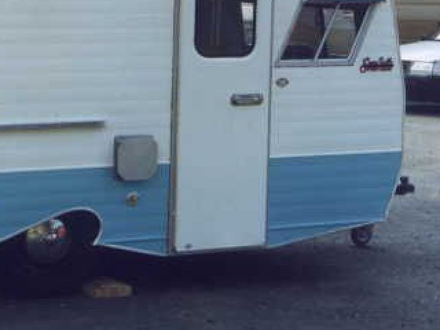

I'm wondering if one dropped the frame under the door, and brought the door down to the level of the footwell??? Like a Serro Scotty? Similar to this...
Maybe even paint the lower part black to reinforce the sleek profile.

"I'm wondering if one dropped the frame under the door, and brought the door down to the level of the footwell??? Like a Serro Scotty?"
Why? You'd be making more work for yourself, adding more weight to the frame, and eliminating that side support for the bed cushion(s). Unless you're building a high-steppin' off-road teardrop like Ryan wants to, or you have some kind of physical disability, entry & exit of a typical teardrop is relatively easy with little fuss (and with a little practice can even be graceful & dignified ;-} ;-} ...!). Remember the K.I.S.S. principle that is part & parcel of the allure of teardropping in the first place.
Here's something else to consider, with regard to door placement: when you look closely at many of the earlier vintage designs like KIT, Ken-Skill, or Benroy (to name only a few), you'll notice that the threshold of their doors are as much as 6" above the floor. Many new(er) builders have figured out that about 2" is all that is needed, and THAT makes entry/exit of the teardrop even easier than it was 50-60 years ago.
