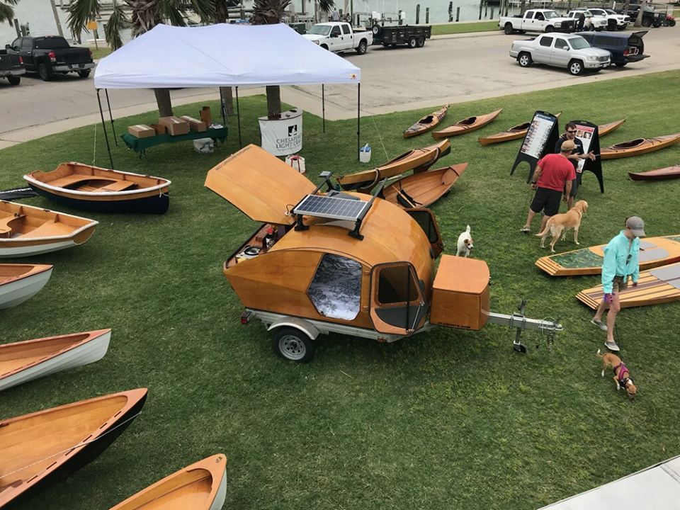

one element most folks don't know/understand it that the CLC design has no framing like most builds
their kits are composed of okoume plywood which is drop dead beautiful and as light or lighter than other species
if you get one of their precut kits the parts fit ... period
except for foamies i doubt you would be able to beat their weight
John brought one to the WoodenBoat Festival @ Port Aransas along w/ a plethora of his little boats and the finer boatbuilders were quite impressed
as mentioned above it would be best suited for one OR a young couple in the earlier stages of their relationship
BON CHANCE
sw

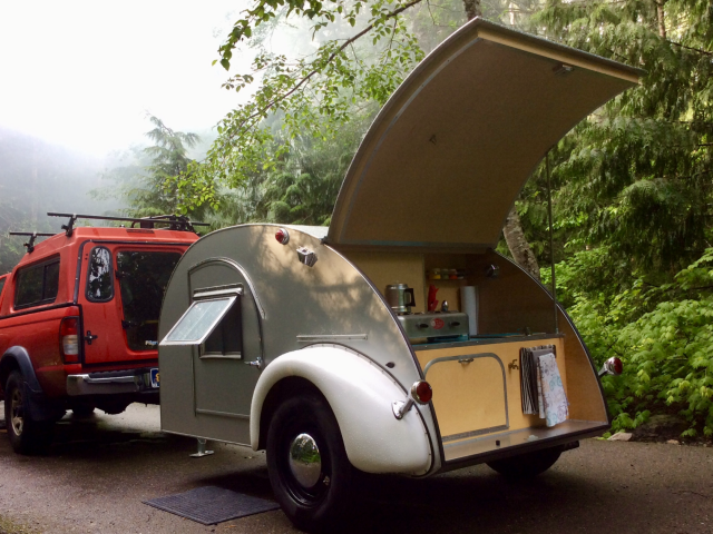

My 1947 Kit reproduction has a scale weight of 800#. That weight includes the rectangular steel grid frame, torflex axle and 15” wheels, original style fiberglass fenders, memory foam mattress, 2-burner stove and a SLA battery but does not include beer in the built-in ice box or water in the 5-gal onboard tank.
The galley on this early trailer design was quite simple and I think this is one area where modern builders get into trouble with weight— cabinets are really heavy. A simple design, even when solidly built, can still come in well under 1000#.
Last edited by mountainminded on Sun Mar 26, 2023 7:33 am, edited 2 times in total.
