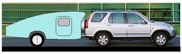

Postby angib » Sat Oct 08, 2005 6:54 am
february1966 wrote:.... How could the trailer's shape effect mpg or speed at all? Provided the trailer fits inside the profile of the tow vehicle and is, therefore, drafting....
Feb,
You're dead right, although there are a few restrictions:
- The trailer should not be too 'awkward' a shape - remember that even the closed tailgate of a pickup affects drag and that's a long way inside the wake of the cab.
- The trailer shoud not stick out beyond the wake of the tow vehicle. Note this includes the underside of the tow vehicle - the trailer should ideally not go below that.
- The trailer should be as close to the tow vehicle as possible. The bigger the gap, the more the trailer becomes a separate vehicle.
An interesting idea is that it would be possible to perfectly match a trailer to a tow vehicle, such that it reduced the drag when towing. The problem is that it wouldn't work on any other tow vehicle and it would have to have a nearly zero gap between the tow vehicle and the trailer.
Perhaps it would look something like this:
Of course, either you can only go round gentle curves or you have to invent the remote-control extending tongue for manoeuvring but, hey, this idea's still under development......
Andrew
