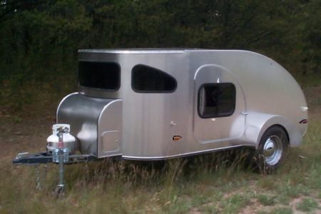

Or the Camp Inn 560 (Raindrop). A very nice trailer by the way.

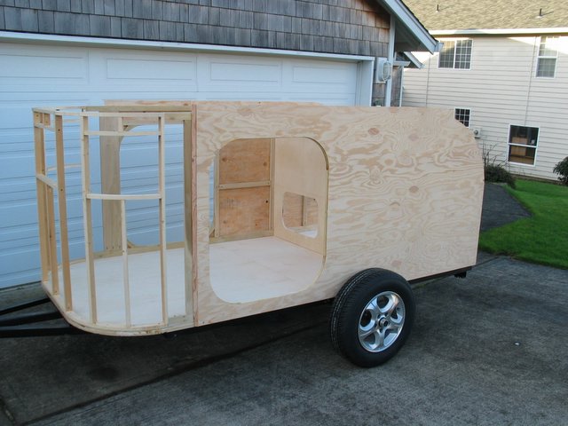

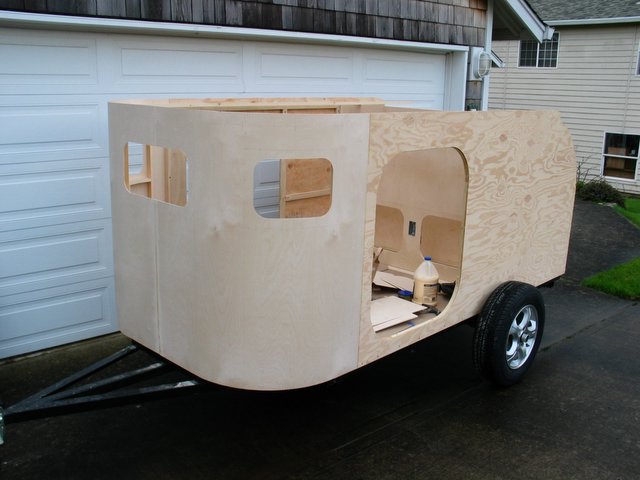

Wa-flyfisher posted a link to the Drip Off album. If you look on page 5 you can see some of the framing for the front. The sides are pretty standard, with 1/4" outside, 3/4" framing and insulation and 1/8" inner skin. About 4" in front of the door hinge, we transitioned to 1 1/2" thick framing, basically 1x2's. Outer skin is 1/8" birch, then 1 1/2" of insulation (Foamular) and 1/8" inner skin. We routed a 1/8" by about 1 1/2" landing into the front edge of the 1/4" side panel so there is a smooth transition between the front and side panels. With the foam in between and .032 aluminum skin outside it is quite strong. Here are a few pictures.
I can't seem to get the first picture in the sequence to stick, but if you look in the album you will see that we built the front framing first (might have been easier to put up the sides first), then put up the sides, then skinned the front.

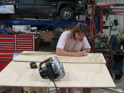

...or you can cut the curved pieces out of 3/4 " plywood like we did here for our galley curve...
This is me playing connect the dots to make the curve before I cut them out with the Jig Saw. This worked well for us. Once we had it in place, we used a belt sander to smooth it to the exact curve we wanted. I don't see why it wouldn't work for you..we were horizontal and you'll be vertical...but the concept is the same...I think! :roll:
