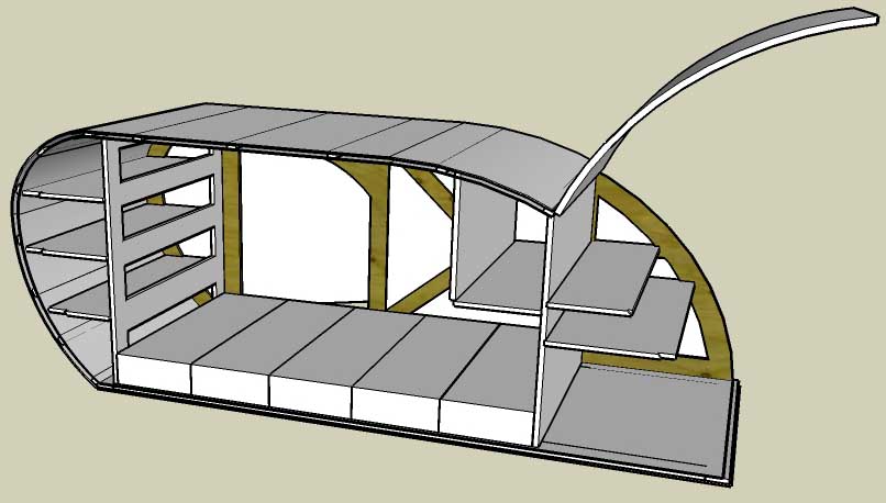

recently I submitted a design for a modified weekender but I got more feedback on the trailer that I was using than the design. Yesterday was the 1st snow day in almost 20 years and we lucked out and got a 2nd one today. I decided to try designing a more traditional teardrop to see if I can get your opinions.
This will be it all closed up.

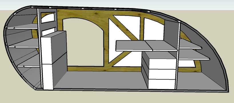

The rear cabinet drops down to become a table if it starts raining on your trip. The pads (bed) can be moved out of the way to make room.

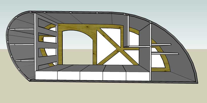

Here is the hatch open

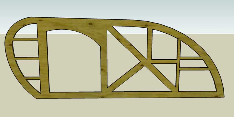

and here is what I was planning on doing for the wall framing. 3/4 ply which can be filled in with rigid insulation.

Postby mikeschn » Fri Feb 01, 2008 2:55 pm
Keith,
You're gonna hit your head on the top of the doorway... otherwise, I like it!
Postby kid_kaboom » Fri Feb 01, 2008 3:00 pm
just out of curiosity, how high are most doorways? this one is 36" high by 30" wide.
I'm still pretty new to this so any help you guys give in the design phase will keep me from making too many mistakes when I build.
thanks again!
Keith
kid_kaboom
Posts: 8
Images: 14
Joined: Sat Jan 26, 2008 4:09 pm
Postby mikeschn » Fri Feb 01, 2008 3:22 pm
I think the optimal doorway comes down 3" from the roof line.
The part of the doorway where you are going to stick your head in the most often is opposite the hinge, and that is where you make the doorway the lowest.
If you offset the roofline 3" and make that the top of the doorway, I think you've gone a long way to avoid knocking yourself out.
To answer you question... I think many doorways are 24 to 30" wide and as high as you can make them.
Postby dhazard » Sat Feb 02, 2008 10:32 am
To make the fold down table more functional you might want to add a foot well.

Postby kid_kaboom » Sun Feb 03, 2008 12:07 pm
So I took Mike's advice and made the door a lot bigger. I actually like it this way so thanks for that suggestion.
As for the table, I hadn't planned on using it all the time because I like being outside. I will probably only use it if it is a downpour outside or the mosquitoes get really bad. I do like the idea of a foot well to put chairs into to get a few more inches out of the design.
As for the fenders I don't know. Some pictures I saw looked like they mounted the fenders to the frame and then built a wood frame around them to dress them up. I kinda like that idea.
I am thinking about building this trailer using a nice plywood exterior and using fiberglass to cover it so I can see the wood grain. My major is construction management so wood really holds a special place in my heart.
I had originally just been planning on using the front cabinets for storage, but now you got me thinking about making the openings bigger. Maybe I'll just put in 3 shelves instead of 4 to get more storage space out of them. I'll work on modeling that up after the superbowl today.
Thanks for the ideas and advice everyone.

kid, what are you using to illustrate these plans? I like the appearance of it.
I also like the modular space-frame type design you've got going there. That will of course be much lighter than a solid sheet of ply, and to be honest, it looks cool.
