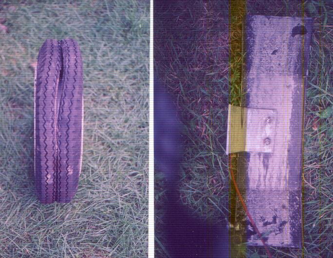

Is it the weigh or the impact that causes the spring to deflect. I thought as you do that the springs could never be overloade. I also left the stock fenders in place to help protect the floor. Here is the results and my axle was in stock position under the springs.
A loud boom at 60 miles an hour indicates you have finally cut clear thru the tire. I went to the smaller 8" tires from a 12" for enough clearance.

Ouch! That second picture - the mounting point for those fenders is bolts that stick down to the tire? That's probably a big design flaw right there. The little trailer I have already has the 8" tires. The fenders mount to the frame from the side - the top is smooth. My plan is to have there be hard stops on the axle before the tire can contact anything - probably bump stops like on a truck frame.
For right now, though, I guess I'll leave the leaves in! My worry is that the hard suspension will shake things to pieces, although with all the gravel roads around here, I at least have a chance to do some testing before hitting the smooth strips of highway.
