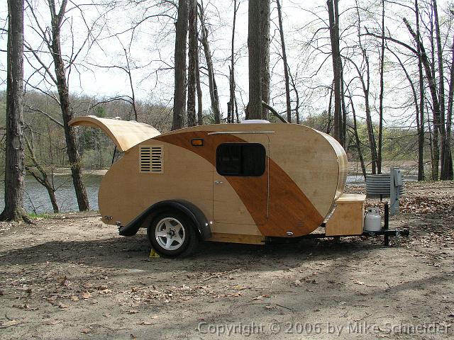

The Lil Diner is 12' long, and it's close to a cub shape...
But we made it a few inches taller too...

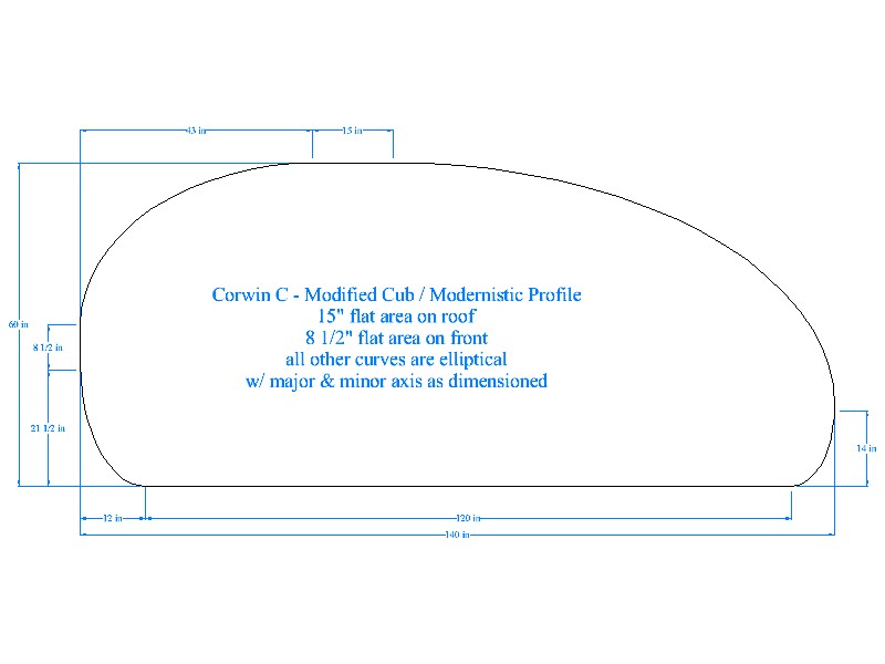

This is the profile that I'm working on ... I'm looking at a 5' x 10' frame.
Still deep in the planning stages ;)

Postby GregB » Tue Nov 03, 2009 11:58 pm
Corwin,
I finally figured out where you are. We have an annual camp out in the mountains west of Koosharem. I really like your profile, but wonder about your flat spots, other than a great place to mount your vent/fan, what do they accomplish?

Postby bobhenry » Wed Nov 04, 2009 12:06 am
Me too.... Sorry but it looks like you didn't plan well and ran off the sheet.
:oops:
Profile
Postby danlott » Wed Nov 04, 2009 2:06 am

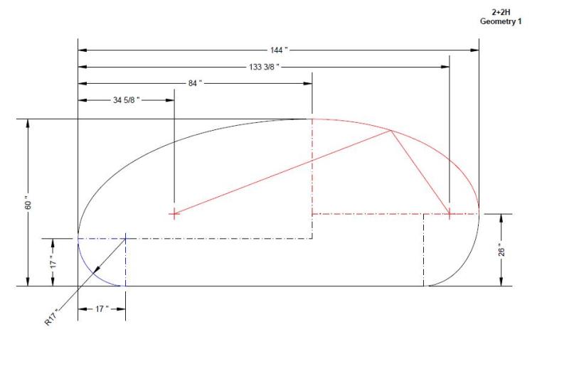

I agree about the flat spots. I do not see much benefit in having them. You might consider the 2+2H profile in the Design Library. It is similar to what you have and the dimensions are almost the same. Good thing about it is that most of the designing is done. There is even a very good frame design with it.
Here is Andrew's 2+2H profile from the design library.

Postby aggie79 » Wed Nov 04, 2009 9:40 am
I guess I'm the odd man out, but I like Corwin's profile as shown.
Aesthetically, I think the trick is to blend the curves into the straight areas which he did. (The geometric term I believe is to have the curves "tangent" to the straight sections.) Short sections of flat area will not pond enough water to worry about.
I have a flat section on my roof that is about 18" (where my vent fan will be.)
Postby Corwin C » Wed Nov 04, 2009 1:41 pm
The flat areas, (besides being areas to mount vents, etc.) allow the curve to be pushed outward and increase the volume inside. In actuality, the only time that the flat areas could have standing water is when I'm set up to sleep inside. Any other time I'll intentionally leave one tire or the tounge either high or low to prevent standing water.
The 2+2H profile is actually where I started, but I wanted to lower the back and have the hatch extend all the way to the floor (too much "hook" in the 2+2H for a full hatch.) I also wanted more volume in the upper front corner (AKA Benroy) while retaining the "Cub" profile.
Tom: Thanks for the support ... I was wondering how many feathers I would ruffle by putting flats on a cub profile, hence the "modified." And if the dimensions and notes weren't on the drawing, no one would know that they're there. :R
