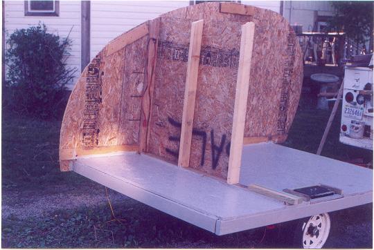

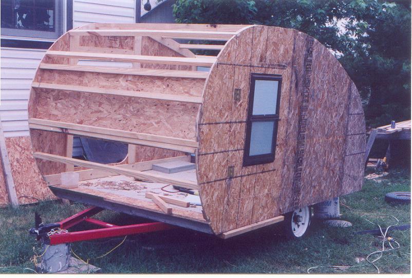

Postby bobhenry » Mon Aug 31, 2009 7:36 am
I think this picture shows what I was trying to say the outside face is all that is extended. The weight of the wall rests on the 1x4 running front to back at floor level. You will notice I used 2 and 1/2 sheets standing up to make the sides. I made 1 break land at the galley wall framing and the other at a door seam to minimize the noticability of the joints. The joints are reinforced with a 1x4 centered over the subsiding seam.
This on showes the 1x4 lap joints The 1x4 at the door nearest the center of the trailer covers 1 joint and the board at the galley is the 2nd, These both rest on the 1x4 at the floor.
As to the axle placement You have enough tongue and that little vee area ahead of the box would be a great place for a tongue box. This addition would negate needing to move the axle farther to the rear. It is in effect the same as having an 11 or 12 foot box. Boat trailers are nice to tow and back up already because of the elongated tongue and I am certain you will have no handeling difficulties.
