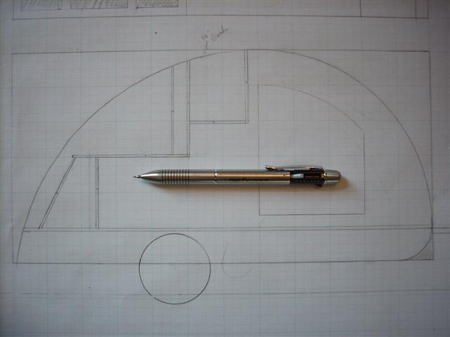

I've decided upon a profile design. I'm not entirely sure about the cabinet and galley layout. It's sure gonna be cramped in this thing, but I don't plan on doing more than a couple of days at a time in this, and it should almost always correspond with decent lawn-chair weather. The wheel isn't exactly to scale, but I went out and measured, so after I flip the axle, the line you see across the bottom should correspond with ground, then the side skirts will ride lower and total height inside should be around 40" at the highest point (which currently corresponds with the cabinet face, so actually less than 40" wherever I'll be sitting, lol.....
doh, just realized this forum doesn't have the "attach image" option whilst posting. I'll get them uploaded and posted in a minute......
