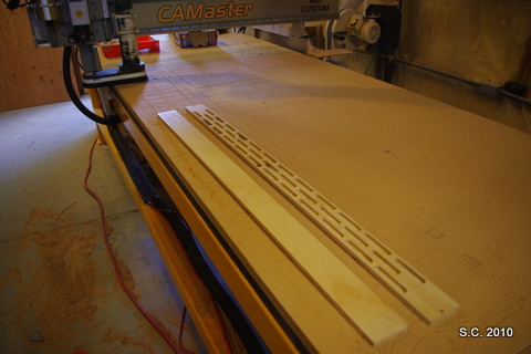

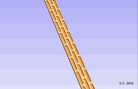

This first image is of a 3" x 52" piece of 1/2" plywood, drawn up in my CADCAM program.
I cut 2 identical pieces one was routed and one was not, and then did a break test on them by putting on some weights.
The routed piece failed at 45 lbs. while the one that was not routed went to 60 lbs before cracking.

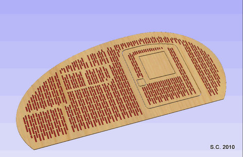

What I am trying t achieve is a 40% or more weight reduction in the walls. Here is a image of one possible way. I will not be routing anywhere there will be frame members or connections to other areas of the trailer.
Any ideas would be appreciated.

Ok, a couple questions.
How thick are the floor in the pockets where you routed?
Are you going to skin the outside with aluminum?
What are you going to use on the inside to cover the honeycomb?
Are you gong to fill the honeycomb voids? If so, with what?
Jeremy

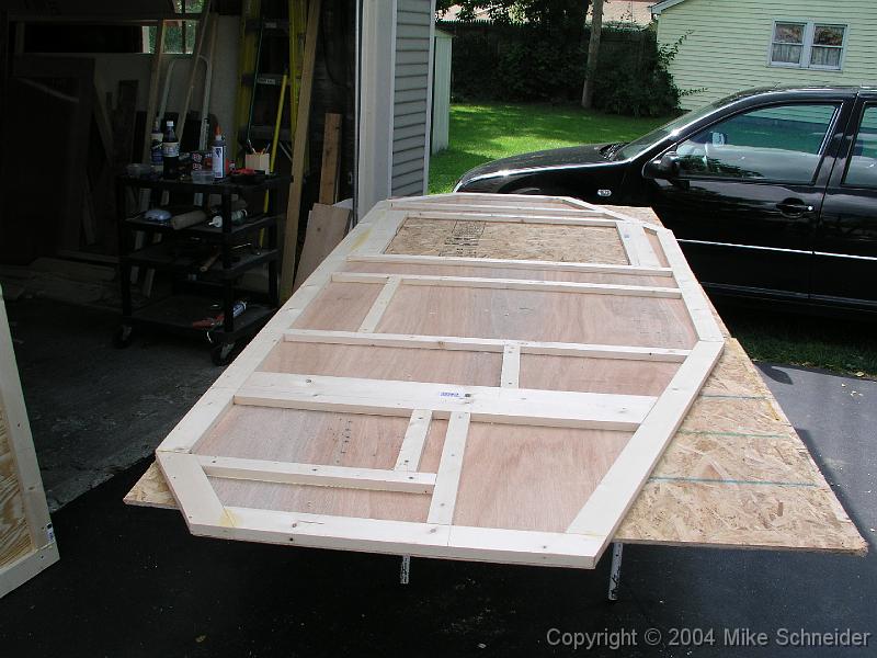

If you are skinning it with plywood, inside and out, you don't need all that honeycomb stuff in there. Just a few structural members, and some EPS.
like this...
Postby R. W. Alexander » Tue Jun 08, 2010 4:15 pm
rainjer wrote:Image
3/8"
Yes
3/4" blue board/foam sheets
blue board, but I will need to figure that one some more.

mikeschn wrote:I think it's a good idea, albeit a lot of work.
I agree. Too much work for the weight savings. There are easier ways to save weight. Neat idea though.

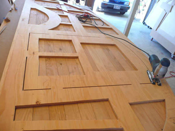

I don't know what the capabilities of your CNC is, but if it can handle 4' x 10' sheet goods (or whatever size profile you're using), I'd be tempted to use 3/4" plywood "framing" instead of stick framing.
I did it the manual way with a template, jig saw and router. Here is a picture of my framing with the interior wood applied:
(By the way, I left about 3" minimum width of plywood for framing. Half that width would still be plenty strong enough.)
Cut the framing, apply the skin, and you're done.
