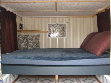

Postby Miriam C. » Sat Mar 05, 2011 10:48 pm
;) you don't need as much room as you think for kids.
If you look at Starleen2's box or mine you will notice that there is room in even 4 feet to put kid feet under the bed at 90°. That will allow you to move a mattress or cots for day time use.
Mine
Scott's---I am sure he has much better pictures. His first two builds could allow for feet to go under.
