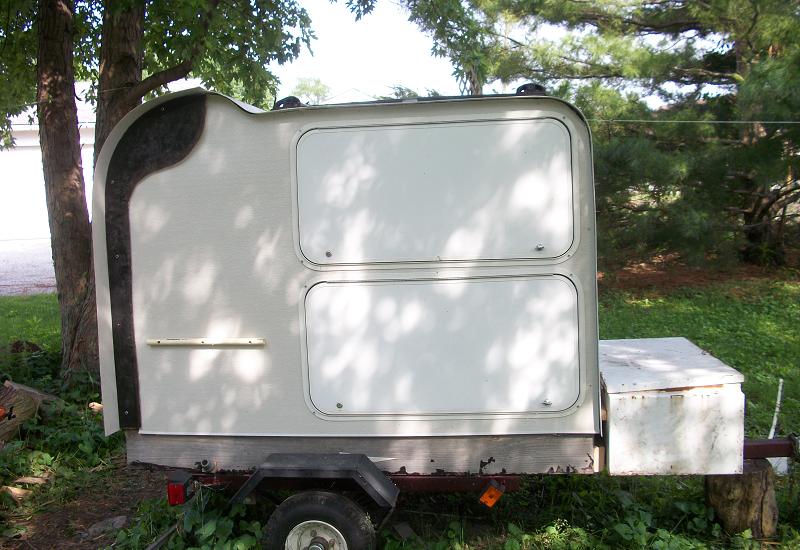

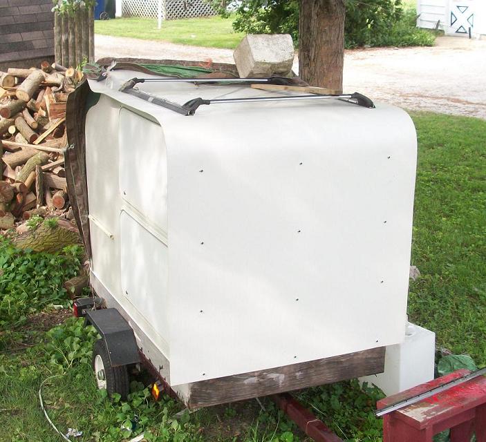

Postby bobhenry » Tue Jun 07, 2011 6:22 am
Formica is not real forgiving when it comes to shock. Any sudden impact and it will shatter. It also doesn't like to bend in a real tight radius.
In the last two weekends I have faced out my chuck wagon with frp panel and I really love working with this stuff. These are the pebbel grained plastic bathroom panels you see in almost all commercial restrooms. I got lucky and purchased 8 sheets of 4x9 off of Craigslist with a dozen edge and joining strips for $125.00 last fall.

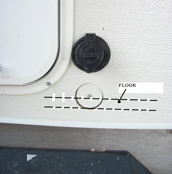

The panels saw well with a fine toothed circular saw or jig saw. I routered the overhangs with a flush cutting bit and a guide on my router. I even free formed curves and rough cut ends with a 4" grinder with the standard grinding disc. It is great stuff available in 4x8 and 4x9 sheets. You can purchase end trim or joining splices in color to match. You can even use a hole saw and goof up if you don't plan well when installing your power port.
OOPS ! Image
here are a couple other pics of work in progress
