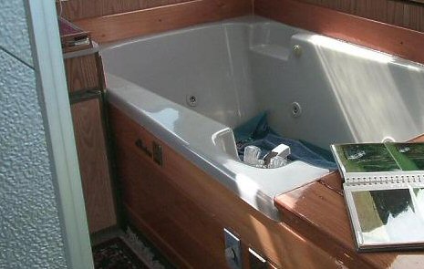

I take it you are not thinking about sponge baths...
Hmmm... lets see what I can find...
how about a tear with a hottub...
Seriously though, would a sit down bath work for you? Have you checked out the cabin car I sent you the link for?
