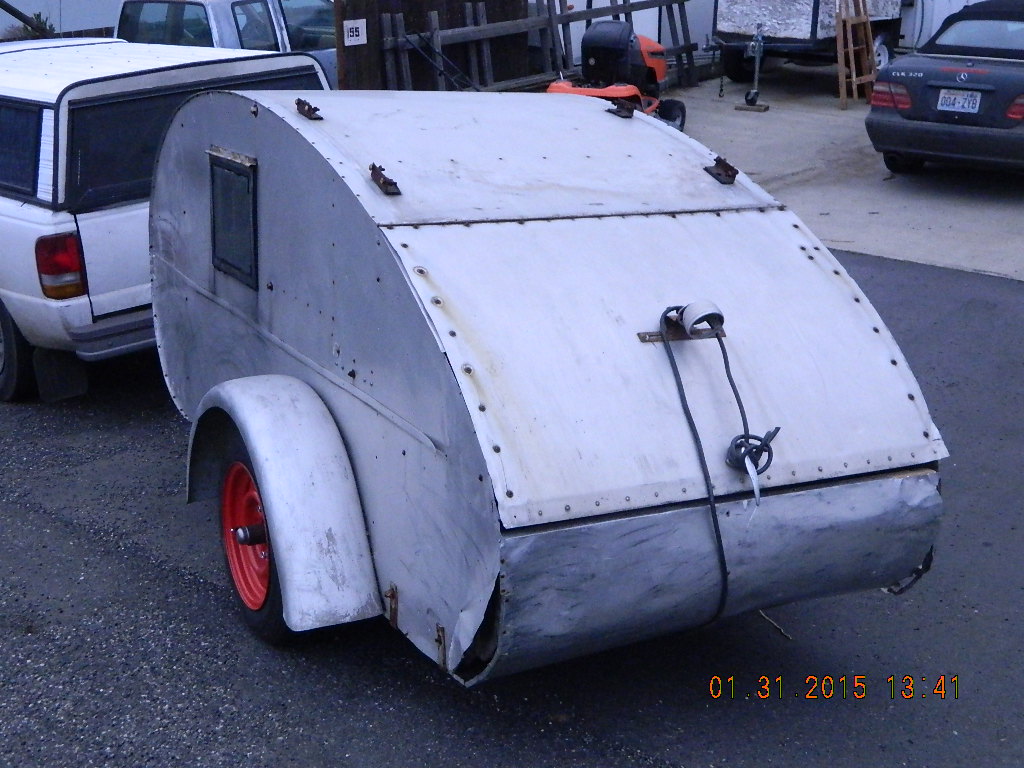

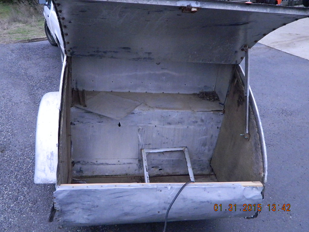

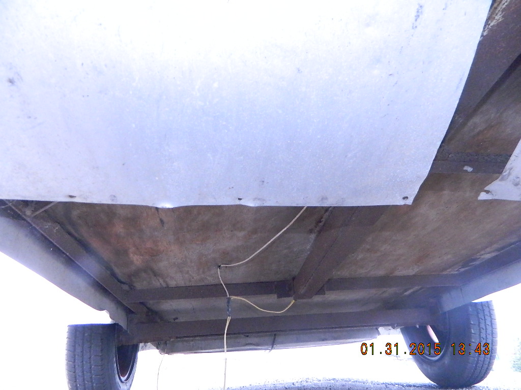

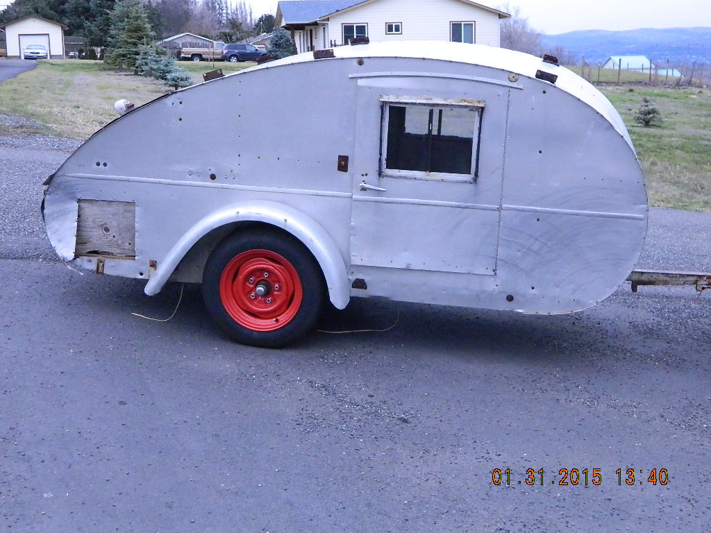

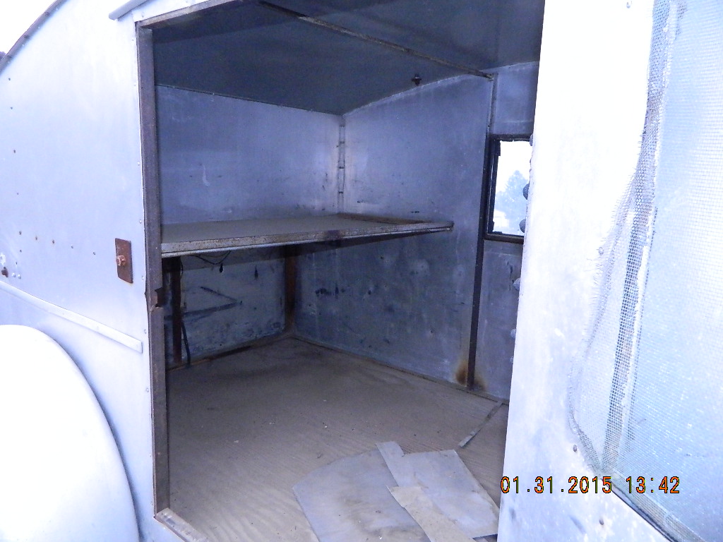

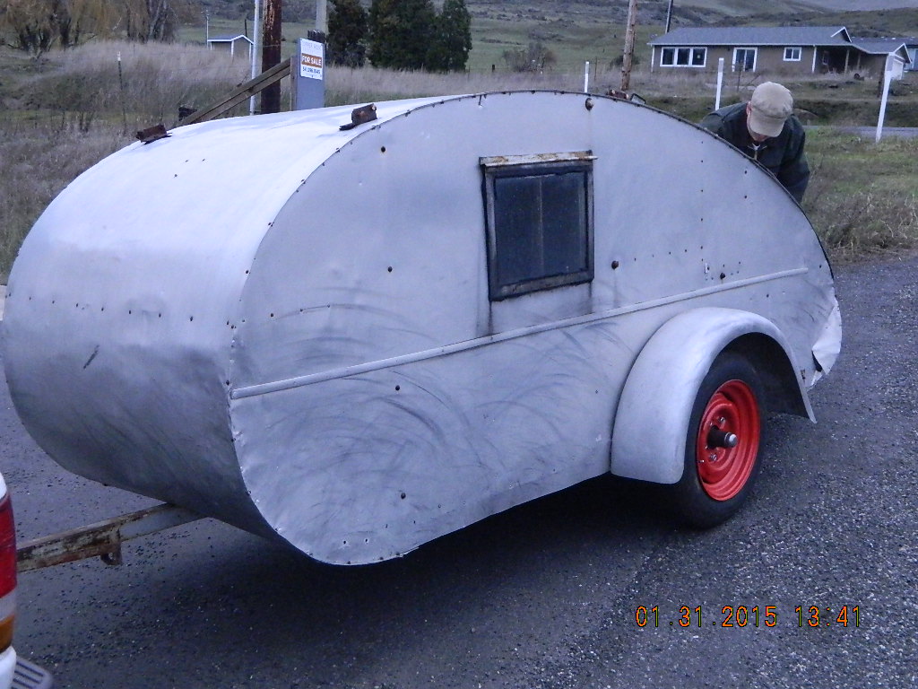

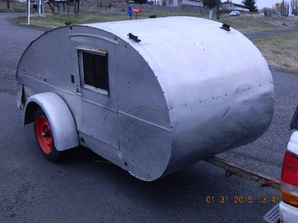

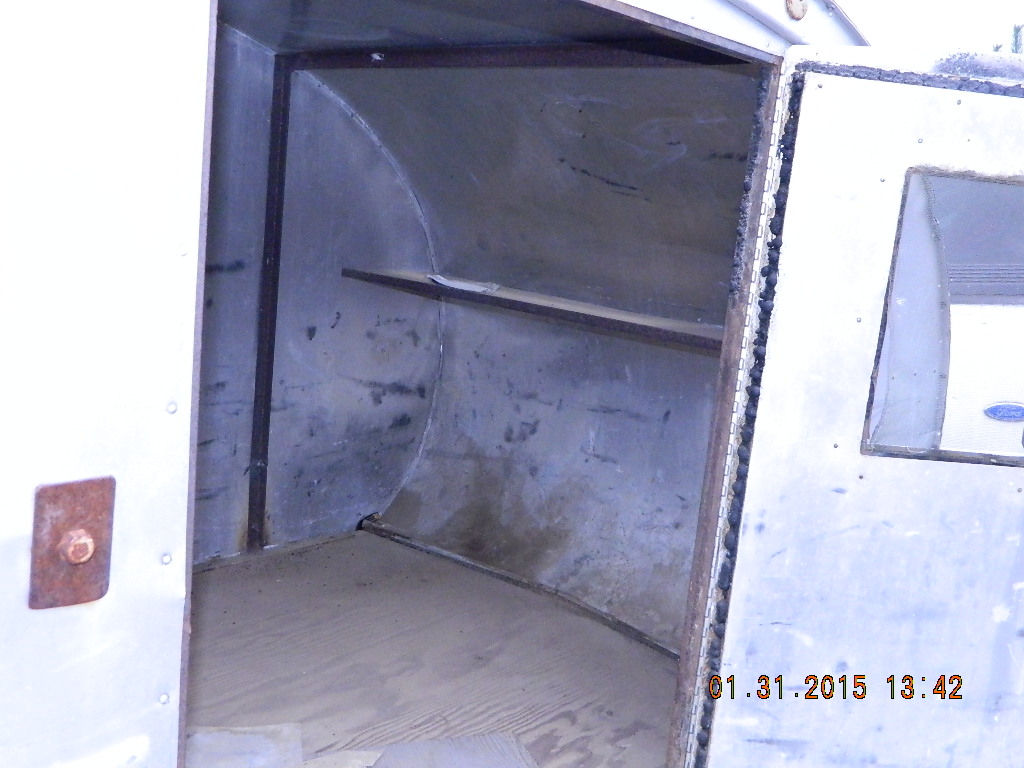

I'm a newb and don't really know what it is that followed me home yesterday. I hope ya'll can help me figure out what it is.It looks like a homer, but may be an old kit. Dimensions are 10' L x 4' W x 4' H at max. As best I can tell, skin thickness is 1/16" (sides and top). Skin fasteners are machine bolts and nuts. Windows/doors are matching, look like they belong there, and are not something scavenged from another source. Lower frame is steel angle iron. Tongue is boxed angle (welded on two corners). Center side trim is riveted and looks like a factory job. Fenders are aluminum. Floor and walls are plywood. Steel rods bolted through across the inside at the top for added strength along top corner. Door/hatch handles look like 40's or 50's automotive, but could also be original to an old kit. Hitch is old-school screw bolt (like and old U-Haul trailer). Single tail light looks like 40's or '50's. Whatcha think?

:o It looks like you bought yourself a wee bit of rolling work. It looks pretty old. Those can be treasures. Be sure to insulate the cabin or you will freeze your tail off. Aluminum conducts both heat and cold really well. But, you probably already know that....

It looks like a Modernaire.
Re: It Followed Me Home. Can I Keep It?
Postby len19070 » Mon Feb 02, 2015 7:40 am
Nice Modernistic/Modernaire/Cub.
http://www.nicksteardrop.com/photos.htm
Modernistic, Cub and Modernaire
Prefabricated Trailer Manufacturing and Modernistic Trailer Manufacturing, located in the Los Angeles area, made these shiny aluminum trailers in the late 1940s. National Trailer Stores, also based in Los Angeles, distributed them. Ads for the Modernistic, which were available as kits for $280 or fully assembled for $500, appeared regularly in popular handyman magazines throughout the 1940s.

Thanks, folks, for your responses. You nailed it. Now I just have to find the serial number. Any hints?
I'll also need to figure out how to deal with a few rips/cracks in the skin. I've searched the aircraft skin repair sites and all I come up with is drill a hole at each end of the tear and apply a patch. Any other sources or ideas? I'll never get to restore it to shiny aluminum because of the dents and I'll have to paint it. I can bang out dents and squirt the zinc chromate and enamel.

I think it might be time for you to purchase an AC / DC tig welder. I believe that you could carefully hammer out the dents and weld the tears. The missing aluminum could be replaced. The skin repair would be a number one priority. There is a metal working forum that comes to mind, MetalMeet. Good Luck with the project.

I wish I was closer to it than just a picture. I'd love to study that TD and see how it was made it looks to me like there's very little wood other than the deck involved. From the pics it looks like it's just a skin just riveted together. It must be made well or it never would have lasted this long. I hope I am around it some time to take a closer look.

The Modernistic/Modernaire TD were aluminum skin over a flimsy steel framework. The only wood was the floor so they didn't have a wood rot problem like all the rest. Since the skin was stressed they all have cracks. I just count them as "character", and I do drill holes at the end at each.
