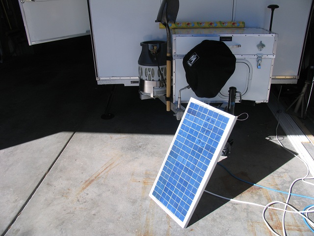

Because of my illness (SPAS - Solar Panel Addiction Syndrome) I bought yet another solar panel for an up coming truck project. I got it from here:
La Vie Solar eBay Linky
This is a fairly small panel rated at 30 watts. One thing most people don't realize is that its a pretty rare circumstance when a PV panel actual produces its full rated power; the panel needs to be oriented to the sun just right, it needs to be a really sunny day and it needs to be a cool day. I've never seen more than 175 watts from the 220 watt panels on the Boxcar roof.
I plugged the La Vie panel into the Sunsaver MPPT charge controller in the Boxcar, propped it up on the tongue and it's outputting 31.6 watts! The output is slowly going down as it the panel heats up in the sun, its at 28.5 watts right now, but the panel performs well.
Since its so small you wouldn't need a a very big charge controller for it, the Morningstar Sungard would be a good choice. It isn't an MPPT controller so the harvest would be down 10%. That's a whopping 3 watts so MPPT would be a waste on such a small panel. You could probably get 10-12 amp-hrs per day from the La Vie panel/Sungard charge controller combination if you moved the panel during the day to track the sun.
This would be a nice, portable PV system for a teardrop that doesn't use a lot of battery. It costs less than the HF system, I bet it beats the HF output and its only a third the footprint.

I wish I had made the cover to the tongue box with this panel.
