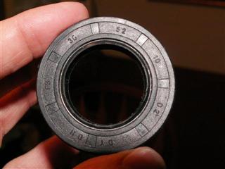

GREASE SEALS: My trailer uses a metric size 30 - 52 – 10 seal. I could not find the grease seals immediately available in Oklahoma City. They had to be ordered and I found the following were available:
HF Part #42708/42709 at a cost of $1.00 each. I also found the following identical seals available: Red Trailers Part #SJ8510-18B which were exactly the same seal as the HF but at a cost of 5.20 each.

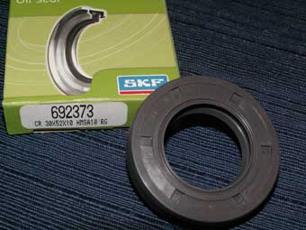

I also discovered there is a company in Oklahoma City that specializes in nothing but seals (SEALCO). I didn’t know there was such a thing as a “seal company”. They had available an SKF Grease Seal #692373 (size 30 - 52 – 10). That seal cost $5.00 and UPS shipping was another $8. BTW this seal was also available in a "hi temp" version for $24.50 if anyone is interested.

So here is what I did: Since my trailer was on jack stands and I was in a hurry, I purchased two of the 30205 bearings at my local auto parts store and the SKF grease seal from SEALCO and had the trailer ready to go within 4 days. I also ordered 2 of the kits from Red Trailers to have as spares in the tool box. I then ordered 10 of the HF Seals at a buck each to use in the future. That gives me a dozen of those hard to find dudes.

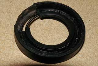

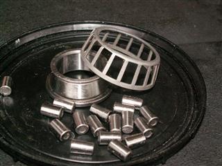

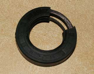

One last note, I will never again try to knock one of these seals out from the inside of the hub in order to salvage the seal for reuse. In so doing, I ruined both the original seal and the bearing. No, I have plenty of spares and will simply pry them out the back side. I noted one post where the writer was concerned about the rubber/plastic construction of the HF seals so I decided to cut up the old one to see how it was made. I found it to be pretty robust with a steel ring imbeded in the rubber coating. They were actually pretty tough and seemed to be well made. They were harder to get out of the hub than you might expect from looking at them.

Rick, I know that method should usually work, and it is exactly the method I was using to remove my inner bearing and seal. It worked perfectly on the first one, but not so well on the second. After several blows with the hammer, it finally came loose but the little spring running around the lip of the seal was damaged in a couple of places and the rubber lip itself was deformed. Also, when the bearing came out it looked like this (after I cleaned all the grease off):
I managed to put the all the pieces back and snap it together, but it all popped loose again when I tried to turn the bearing.
Some of you guys just seem to have the right touch when something is supposed to work a certain way. Unfortunately, I sometimes have the uncanny ability to wreck an iron ball.
