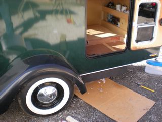

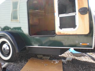

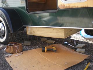

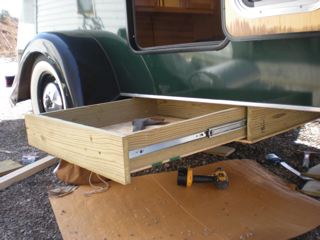

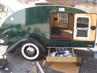

Hi Spent the day in the drive working on the drawer. Tell me what you think. I'll try to get better pics, sun saw getting to low. The spare is still 2" lower. Made the box 6". Have not put a lock on it yet, just used two wing nuts for now. Erv
