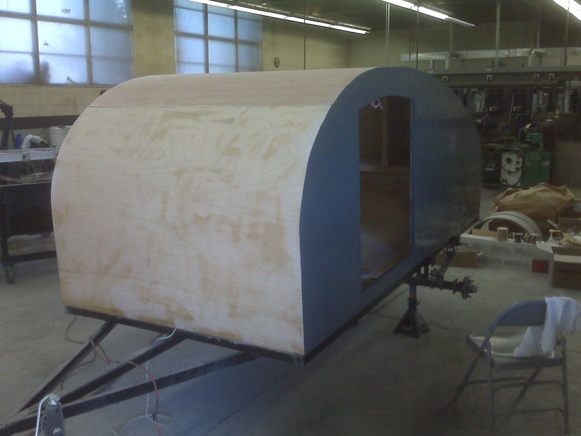

I got ahead of my myself and forgot to remove the wax from the epoxy before the last sanding.
:cry:
Now I have a few options...
  • Remove the wax at this point and hope for the best.
  • Apply another coat of epoxy - this is complicated because the sides are now in place (vertical) which will make it's own challenge.
Any thoughts on my problem an what the best solution would be. If I need to put another coat of epoxy in it, what is the best way to get a thin, smooth coat on a vertical surface?

Postby Steve_Cox » Sun Jul 26, 2009 6:26 pm
Amine blush can appear as a wax-like film on cured epoxy surfaces. It is a byproduct of the curing process and may be more noticeable in cool, moist conditions. Amine blush can clog sandpaper and inhibit subsequent bonding, but it is water soluble and can easily be removed. It's a good idea to assume it has formed on any cured epoxy surface.
To remove blush, wash the surface with clean water ( not solvent) and an abrasive pad such as a Scotch-Brite. Dry the surface with paper towels to remove the dissolved blush before it dries on the surface. Sand any remaining glossy areas with 80-grit sandpaper. Wet-sanding will also remove the amine blush.

Postby crazycyclist » Sun Jul 26, 2009 8:29 pm
After looking at it again this morning, I decided I need to sand it again I treated the epoxy sanded again with 80 grit and then treated the epoxy again. Now I've got a coat of primer on so I'm feeling pretty good!
