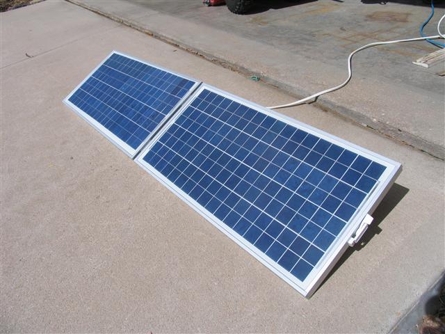

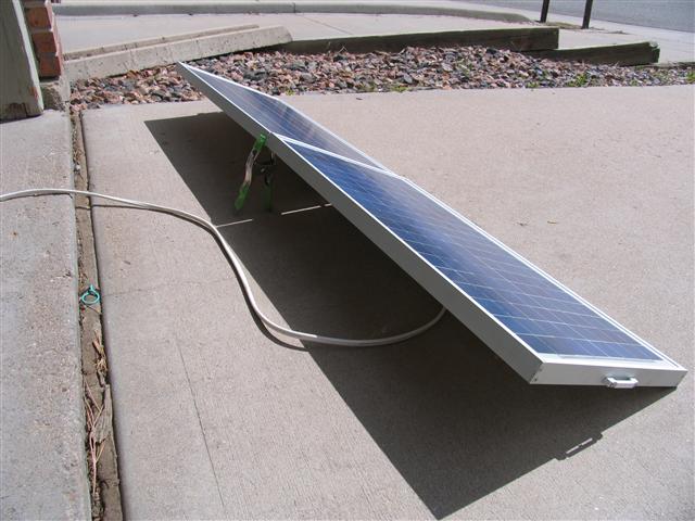

A while back I bought a 30 watt PV panel to run the refrigerooler. As part of my solar addiction I bought another 30 watt panel and made a folding 60 watt panel. Here it is unfolded and in the sun, I definitely like the lower profile of this one versus our80 watt folding solar panel:
I was going to add a leg to the back to prop up it up but I think I like a clamp well enough that I won't bother with a leg.

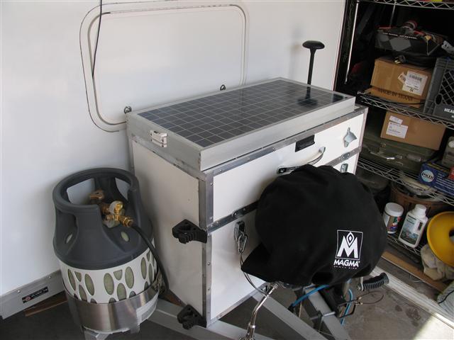

Here's a picture to give an idea of how big it is folded up. I think this size would work well for a Teardrop.

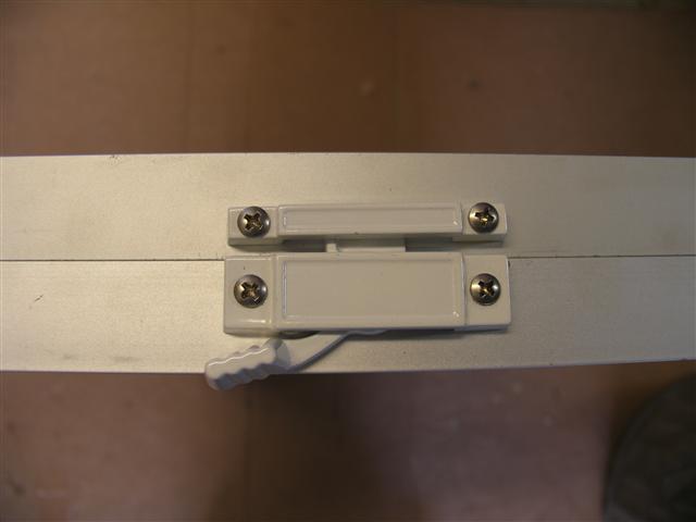

I used a window sash lock as a latch to keep it closed

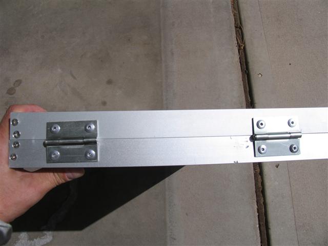

A couple of hinges riveted on. I never do seem to get hinges centered right but this will work well enough.

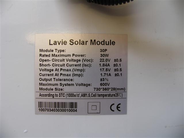

Here's a picture of the panel specification sheet.

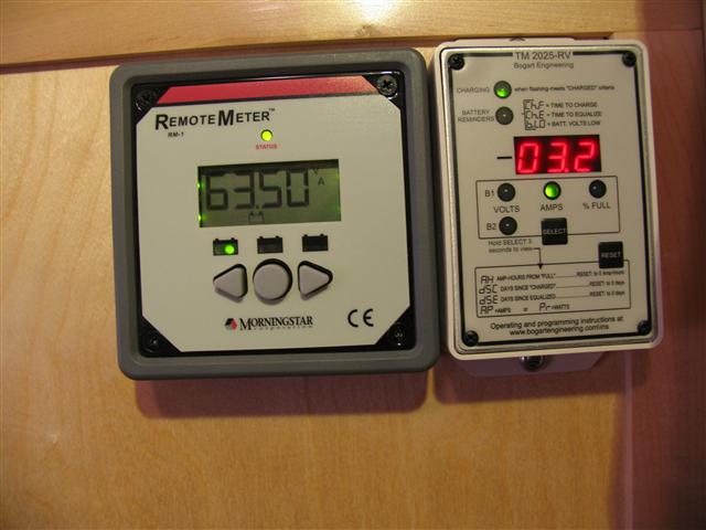

How does it perform? I hooked it up to the trailer so I could use the MPPT controller to check the output. It's a cool day but at 63.5 watts the panel is putting out more than nameplate wattage. This will drop when it gets hotter outside but none of the other panels I've bought have performed this well.
Here's the output in amps, the meter on the left shows panel output, the meter on the right shows the total amps going to the battery. The one on the right is lower because I had some lights on. Notice that the output at 4.22 amps is higher than the Imp rating (3.42 amps) of both panels. That's the Sunsaver MPPT controller in action.
