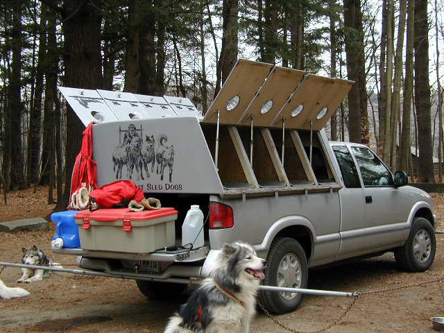

Postby M B Hamilton » Wed Aug 30, 2006 9:11 pm
Top hinged doors is something I have some experience with, I've built a few of them (23 so far). I've found the "spring pops" for pickup toppers to be excellent supports for the application. Keep a little oil in them and they move freely and aren't too noisy. No annoying gas leaks.
But the mechanism does impinge on the entryway. And that could be significant with a teardrop doorway. Also, it impinges on the interior surfaces when the door is closed. Finally, if the person using the entryway uses the support as a hand-hold they are likely to knock themselves on the head with the door (that, sadly, is experience speaking).
Good things? Lead that list off with "get them out of the way". Also keeps rain off your head when you're under them, but on a teardrop you'd likely need the door to pop well up so that you can get close enough to the trailer to use the entryway without crawling on the ground. That would limit it's rain shielding ability. I've never had to use more than a stainless steel piano hinge, but we've only had to deal with frozen precipitation. You'd need a waterproof solution.
That's all that comes to mind just now.I know the picture is kind of "doggie". Sorry, all my pop-up doors have been for "doggie" persuits. The picture does illustrate what I'm talking about however.
