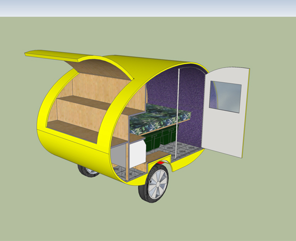

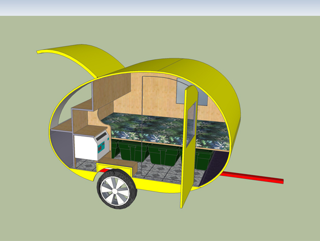

Apparently, I did not seal Itty-Bitty as well as I thought. She/he/it has developed cancer (a serious case of side wall de-lamination, not the masonite roof). I'm going to use her the way she is as long as possible; but in the mean time I've been playing with designs to rebuild her. Those who know me, know my affinity for the 40" wide trailer built for one person. I plan on re-using the same trailer frame. The design I'm currently playing with is the Midget shrunk to fit.... kind of a Mini-Midget. Which brings me to the point of this missive. Preliminary drawings show the trailer body being approx 4'6" wide (over the wheels). I would like to make the hatch in from the edges about 8" on each side. I'm drawing a complete blank on how to frame and seal the edges. Any thoughts/input would be greatly appreciated.
Just the rough drafts so far....
(I was able to figure out a way to even squeeze in a small a/c unit that Itty Bitty should have had right from the git-go!!)

Well, first off. Why stop at 4'6". I'd go on out to 5' and then make your hatch 4' wide and 4' high (arc). That gives you 6" on each side. Then frame the opening with 1/4" x 2" framing stock and nest the hatch in the opening. Does that make sense. :thinking:

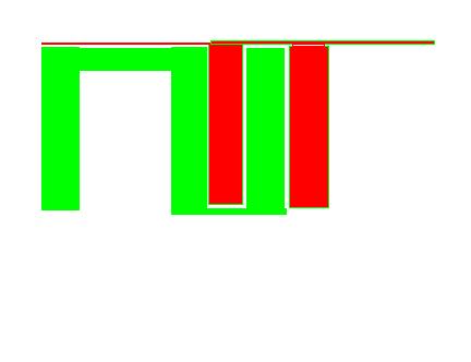

First here is my full radius hatch supports this is what the color drawing is trying to represent
Now with a big curved 1x4 2x4 whatever.......
The green is the trailer side you frame this upside
down " U " just like a tear roof side attached to mini
spars and the curved final bow for the return
(just like above) now you fasten a under skin of
1/4 ply and another bow this forms the right side
up green "U" this will be fiberglassed and used
as the rain channel. The red is your hatch you
have an inner bow to strengthen your hatch
then the outer bow fits into the rain gutter being
hung by the outer hatch skin. The bottom of the
rain gutter should have a clear path to the outside
without interuption. Since you have essentially a 1/2
hatch ending at the counter some type of a catch cup
and drain tube will be needed to allow the water to
daylight out
Gasketing could be added but may prove unnecessary.

I like your rough draft. If you build a small platform on the wheel well, you could put a porta potty there, in front of the a/c

A big THANK YOU for the responses to my question. It was enough to break the "writer's block" I was having. All it took was a gentle nudge and now I have several different ideas percolating in the grey cells to decide which will work best for my application.
Bobhenry... you make a good point about uninterrupted flow using the interlocking U method. Some form of scupper will definitely be needed if I stay with the half hatch.
Len.... my father used to tell me the same thing when we used to build houses together. I was always trying to over think things. The K.I.S.S. method still works. And mean old Mr Gravity can be our friend at times. If I decide to go with a "dam" method, I'm thinking of using some type of T-molding around the hatch edges.
Gage... The 4'6" width came about initially because I took the original Midget plans and just shrunk them proportionately to fit my little mini trailer frame. I was concerned about going too wide overall for it's wheel base and getting side to side imbalance when towing. I took some accurate measurements yesterday evening and the outside to outside of the tires is wider than I originally thought, so getting that extra 6"inches of width shouldn't be a problem. I'm going to flip the axle to the top of the springs. It will lower it about 3" and should help with the center of gravity.
Mike... Getting compliments from you the other Masters on this board is like making the "Dean's List". Before the last hard drive crash, I think that I had worked up every trailer in the design library and vintage plans section in Sketchup. (They are gone now. Another reason I have to get back in the habit of backing up.) I enjoy putting them together in the computer as much as I did when I built Itty Bitty. I just wish I had the funds and time to actually build them all.
Now I just need to wait to establish a building fund so I can get started on the mini midget (Itty Bitty II).
