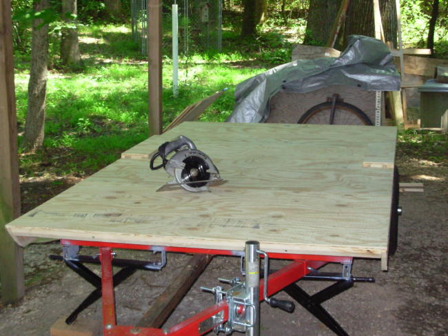

Do yourself a big favor and extend the tongue now ! I did not ,and that will be a project this summer . With the body on , it becomes much more difficult. The tongue flexes on mine to the point of being worrysome to me. This pic was borrowed from a fellow forum member and shows a great way to neatly add the length and strengthen the tongue. One chunk of 2x2 x 3/16 or 1/4" wall steel square tube about 30 - 40 bucks and well worth the expense.
With the 2 foot added you should be able to shove the body forward on the frame and while the wheels remain in their original position the balance point has been shoved to the rear. Mine was designed 60 / 40 and I have a bit of sway at highway speeds you might want to consider axle center line at about 42 " from rear (65/35)

That's my HF trailer in bobhenry's post (thanx bh for the plug ;) ). I used 2X2X1/4" square tube for the tongue ext, along with 1 1/2"(?) angle between crossmembers 1 & 2. I did move the axle to the rear but not more'n 3 or 4 inches. My TD is 60X116" outside measure so it isn't quite 10' long. The floor was (I think :oops: ) 60X110". You can easily build a 5X10' TD on even a 4X8' trailer so building on the 5X8' should be a snap. I used the 1740# 4X8' because I wanted the 'track' to be no wider than my tow vehicle & on most trailers with 5' wide frames the wheels extend further out than my truck width. Also, using the 12" wheels/tires enabled me to build 'over' the wheels & only have about a 1" high 'wheel well' in the cabin which causes NO discomfort with the 5 1/2" memory foam mattress :thumbsup: . I did eventually install a 1" thick steel 'spacer' between the axle & spring seats to prevent possible contact of tire/floor on especially rough roads, potholes, etc. Never had that problem but thought metal fatigue of the springs might eventually cause one. My album shows pretty much the way I did the tongue ext & 'framed' out the floor -
