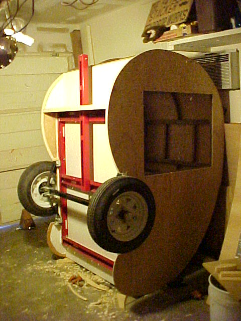

Postby Roly Nelson » Sun Mar 20, 2011 7:59 pm
Well it has taken 6 years, but it is finally finished. It only sleeps one, is 40 inches wide, 72 inches long and flips up on it's back end when stored against the wall in the garage. My feet touch the hatchlid, but shouldn't be a problem. I've kept the weight down by building with 1/8" plywood, a hollow-core door for the floor and no storage cabinets below the galley counter top. So far according to my bathroom scale, it weighs in at 245 lbs.
Being a first generation, Ameican-born Swede, I decided to paint it with the Swedish flag colors. Blue body and yellow fenders and window trim. Since my teardrop shaped windows don't open, I have built folding, removable screens to allow air flow in the opening below the gallley counter top and up through the roof hatch. If that doesn't do the job, I'll consider a remote 110 volt AC unit that can pump cool air inside. This might be required when I take it to Minden this summer.
During a test run, I was amazed that I was able to reach the top of the onramp to the freeway, doing 70 mph with my 4 banger Camry. If I was able to get 28 mpg pulling the heavier woody, I should be able to get 30 mpg pulling the "Stacker". We'll see. So, Lake Perris, here I come.

Congratulations on the 1/4 Nelson stacker's completion! I'm guessing that you're going to do the 'unveiling' at the gathering?
One more question...How do you lift it up to stack it like this if it weighs 245 lbs?
