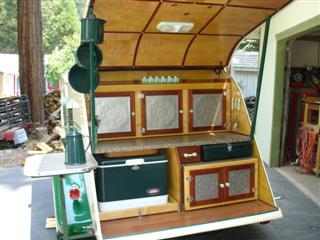

This is the only pic I have at the present time...but the Coleman stove is attached with a pantry underneath it full of pots and pans. Also behind the stove is a storage compartment for large cooking utensils. The cooler also slides out. I've done this type of arrangement on all my tears and it's worked really well for me and the others that have bought them. It gets the stove out so that you are closer to the burners on it and helps to keep the cooking crud out of the galley. Make sure you get it at a good working height, close to a typical stove type height. I used the 100# sliders from HD on the stove and cooler sliders. Doug
Here it is all folded up.
Another version.

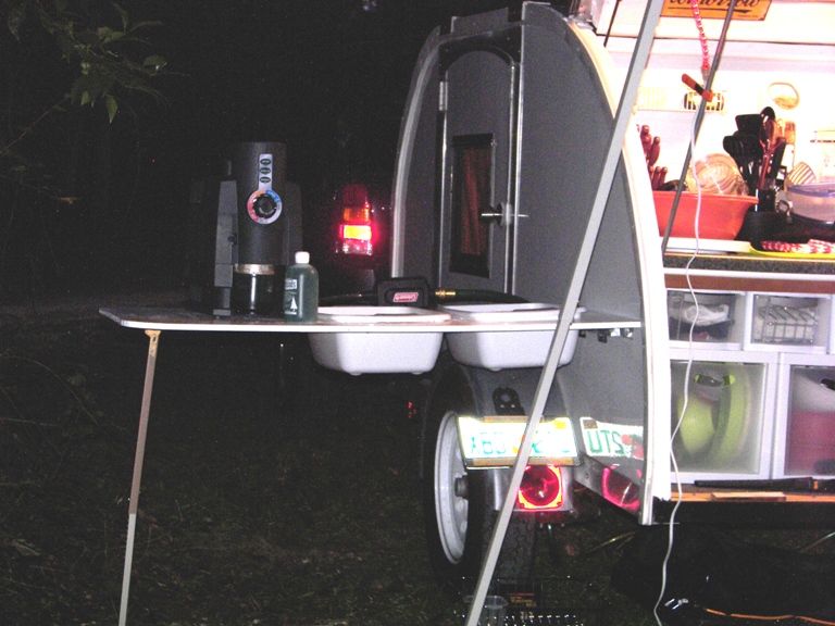

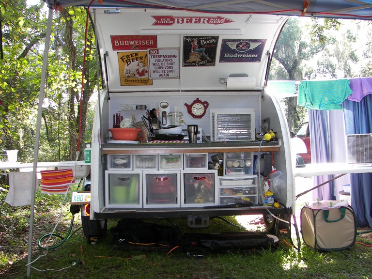

I think the most practical way to add space for you, would be the addition of 2 side tables. One to cook on and one as a clean up station.
This would get your stove away from the hatch and give you a lot more elbow room.
A wash and rinse sink and a dish drainer would be simple .
I stole these pics out of Becca's album. They are great examples of what I am talking about!
A simple under body rack could be made to store them in transit
Note the different heights!
counter height 35 - 36 inches for the wash station
and 28-29 for dining table height.
