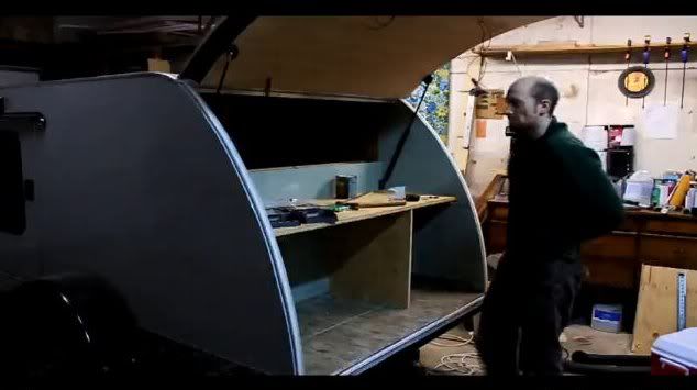

I just put the galley gas struts in the jPod. They are 100# & work great. My only complaint is that when I close the hatch, they push so hard that it pushes the middle of my hatch out off of the seals. I am tempted to go with 80# struts but worry that it wouldn't be enough.
Here's a video of my problem: http://www.youtube.com/watch?v=5bPyWzn3y9Q
Anyone else experience this? If so, how did you fix it?

Postby greekspeedoman » Wed Feb 17, 2010 12:57 am
The hatch fits great without the struts in place. They are causing my problems. I've used the trailer for a year and just now decided to upgrade to the struts. Of course, Now I have problems...
I'd prefer to keep the geometry I have in my video clip. I'll see if a different lb strut helps. I can see the wisdom in moving the bottom out to press against the hinge. My only concern is how this would change my counter top plans & I'd need to get shorter struts.

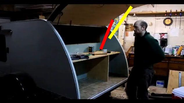

Postby planovet » Wed Feb 17, 2010 10:35 am
I'm no expert but the struts look like they are mounted too close to the hinge. I mounted my struts where they mounted further down on the hatch. I used 150# struts. In my case, they don't push on the hatch at all when closed.
How I mounted mine:
Yours currently:
Possible solution, moving from the red area to the yellow area.

Postby halfdome, Danny » Wed Feb 17, 2010 11:00 am
It looks like you have more than ample head room when opened.
It looks like your at your maximum on the galley walls.
Try mounting the brackets an inch down the hatch in increments until it closes completely and then cover your holes with some nice molding.
If possible get inside and have someone close the hatch so you can watch the action. :D Danny

Postby Cliffmeister2000 » Wed Feb 17, 2010 11:03 am
Hi, Mark,
I was having a similar problem and emiller told be the hinge and the shock mont w=should be within 6" of each other. Fixed my problem. So, I guess I'm agreeing with Planovet (Mark (& Cindi)). Move the bottom to within 6" of the hinge, and move the top out as required.

Postby greekspeedoman » Tue Mar 09, 2010 11:20 pm
Gage,
I moved the hinge point about 6 inches below the hinge (like Mark suggested). The bulge went away.
In retrospect, this makes perfect sense. The compressed strut pressure is pushing closer to parallel with the hatch rather than perpendicular.
