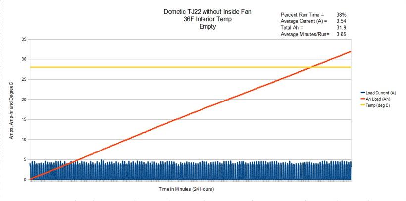

The first test I ran was with the interior temp set at 36F and the outside temp at 78F. I wasn't happy with the amp-hr usage as it was higher than I expected compared to the Waeco. 31.9 amp-hrs is higher than I'd like.

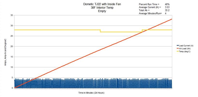

An interior fan helped a lot with the 3 way fridge so I tried that. The interior temp went up to 38 but I imagine its more uniform inside. It didn't help at all, in fact the energy usage went up a little. Its not worth the energy penalty of running the fan (I only measured the fridge usage, the fan is not included in the measurements). I don't know why it went up, maybe it increased the heat transfer to the walls?

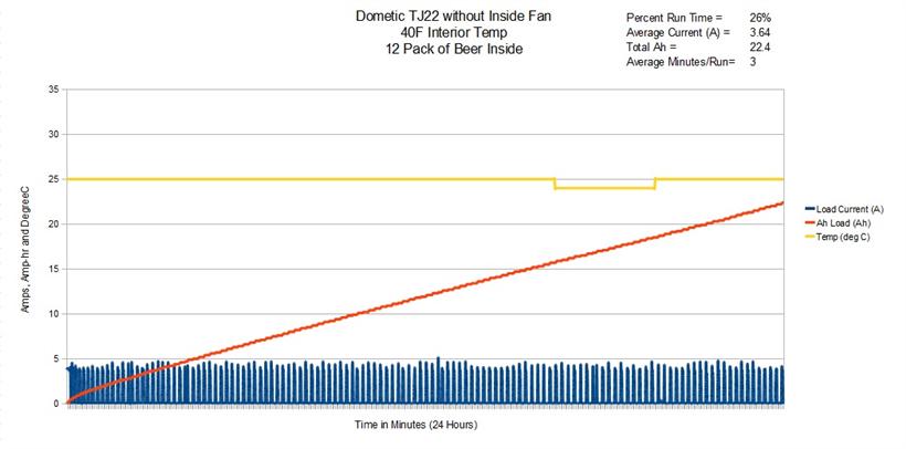

Then I tried it with a 12 pack of beer inside to see if that helped by adding some thermal mass. The amp-hrs is down a little but I think that's because the exterior temperature was down at 75F. The beer was already cold, the fridge was off and warm at the beginning of the test. I wanted to see the effect of adding already chilled items to the fridge. All other tests were with the fridge already cold. Adding the beer and starting up the fridge didn't affect the usage much. It took 2 hours for the temperature to get to 40F.

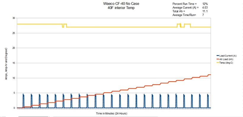

For comparison, here's the Waeco test results. The Waeco runs less often than the Tundra but runs longer when it does. It also has electronic temperature control while the Tundra runs off an mechanical thermostat.
The Tundra is almost exactly twice as big as the Weaco and the energy usage reflects that. I've added some extra insulation to the Tundra but using twice as much energy for twice as much interior room seems about right. I don't care much what the usage will be during the day as I have solar panels that can easily run the fridge. The night time usage is manageable for me at around 1amp-hr (assuming I keep it at 40F overnight). I've added 10-15 amp-hrs to my night time usage, which is around 25 amp-hrs now. These aren't real world numbers since I didn't open the door but it should give a better idea of usage over guessing based on the fridge specs.
