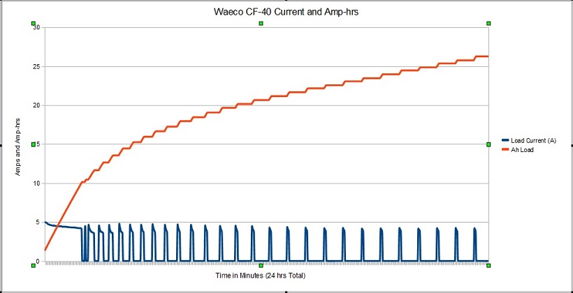

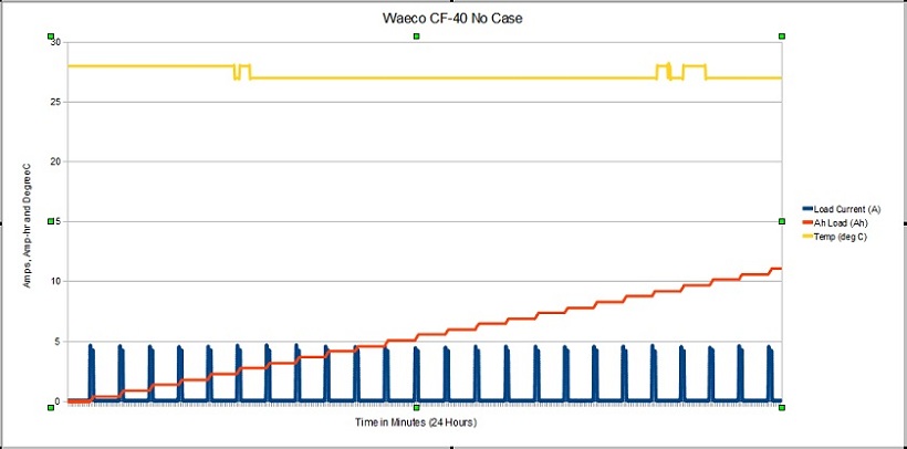

One big argument seems to be that the Engel uses less power than the Waeco. I believe that's true but I'm more interested in the energy usage than I am the power usage. I don't care what the amperage draw of the refrigerator is (power) as much as I care about the amp-hour usage (energy).
So I measured both last night.
I plugged the refrigerator into the load output of the Morningstar MPPT controller for the solar panels. I have the optional meter that measures current and amp-hours. Here's what I found.
I turned the fridge on at 8:00 p.m. last night. It had been sitting unplugged inside the trailer for a week and was at 80F inside and out. The fridge was empty for the test, I'll fill it up and test it some more later. I set the fridge at 39F as that's probably the warmest I'll want it set at. The warmer the fridge, the less energy it uses.
The load current started at 3.8 amps and slowly climbed over 5 minutes to a peak of 5.5 amps. Then it slowly fell back down to 4 amps over 10 minutes or so. The battery charger was on so the voltage was at 13.2 volts. For comparison, the Engel has a maximum current of 2.5 amps. After an hour, it was at 39F and the compressor had cycled off.
At 6:00 a.m. in the morning it was at 7.7 amp-hours of energy usage. The temp was still 80F in the trailer. The total energy usage after 24 hours was 14.7 amp-hours and the interior was still at 80F. That's pretty darn good, less than 1 amp/hour average usage. Its also the best case scenario as I never opened the fridge during the test. I don't expect it to be that good when I'm grabbing beers out of it all day. I threw a 6 pack in it tonight and I'll run the test again for 24 hours.
So it looks like the electrical performance is pretty good. The maximum amount I've harvested from the solar panels is 59 amp-hours in a single day. That's without tilting the solar panels so I could probably harvest at least 10% more with perfect orientation. The most I've ever used in a night was 44 amp-hours in the winter with the furnace running all night (I also fell asleep with the DVD on). I think I'll be able to use the fridge as long as I want without worrying about running the batteries down (assuming the sun shines every other day or so).
