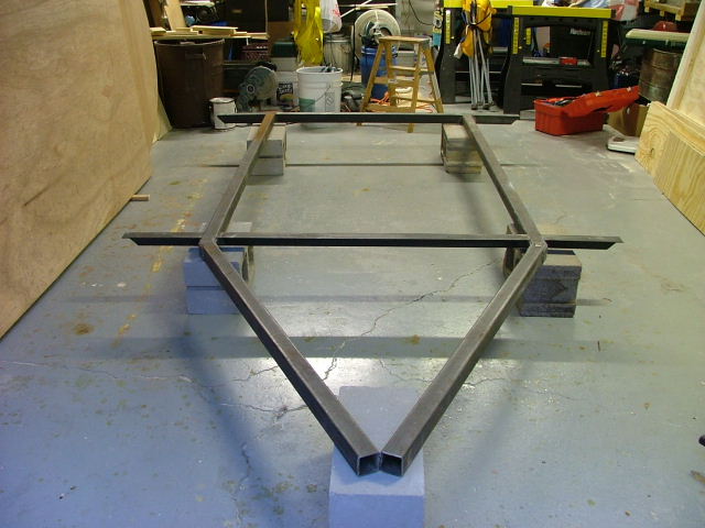

Basic frame..........

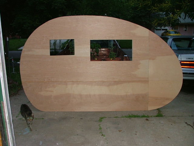

Side profile...........

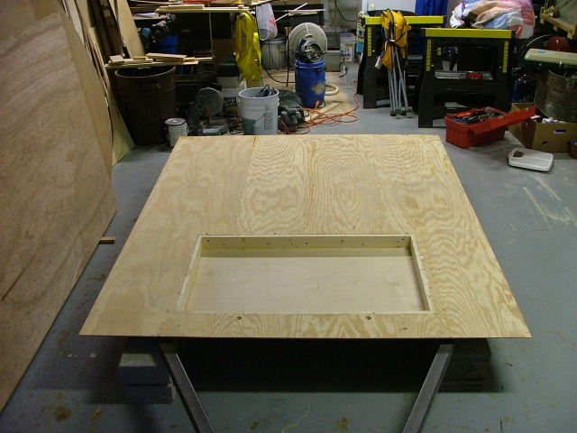

Dropped floor, 2.5" deep (we're short).........

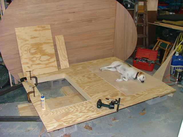

Boomer is helping here................ yeah, right!!!

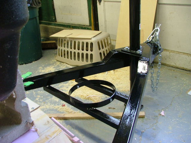

LP bottle mount

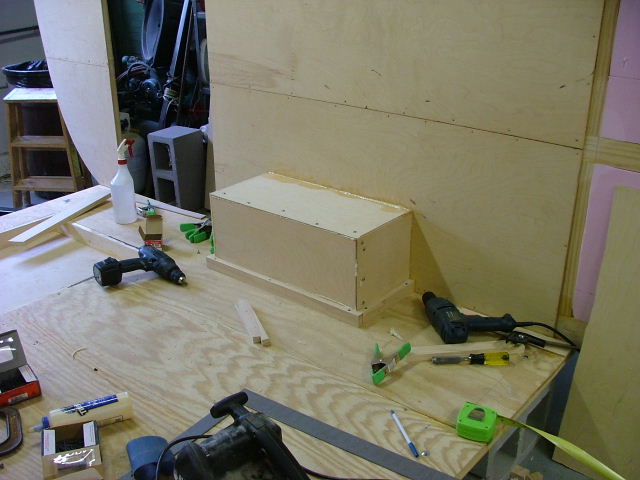

I used this technique to attach the walls to the floor. What I did was run some 1X2's through my table saw and made one long groove to put joining biscuits into. The walls were mostly skinned on the inside before I ran one big gob of glue on the bottom cleat and dropped the wall on it. I did it this way so as to have the best (IMO) possible surface area for glue to stick to and not have any cleats showing on the inside...

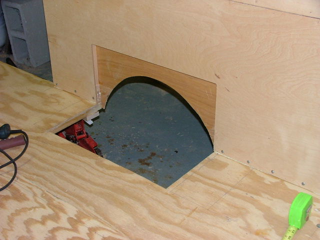

Here's the wheel well all covered up.....

Thanks, Mike, Dave and Bruce..... Bruce, the screws you see are mearly "clamps" to hold the skins to the cleat until the glue dries and then they are removed. The floor cleat is held in place with screws coming up through the bottom. I didn't want any fasteners to show on the inside or out. It seems to be plenty strong because we took it on it's only trip (1,100 miles or so) and it didn't fly apart and we had a VERY bumpy ride there and back.
