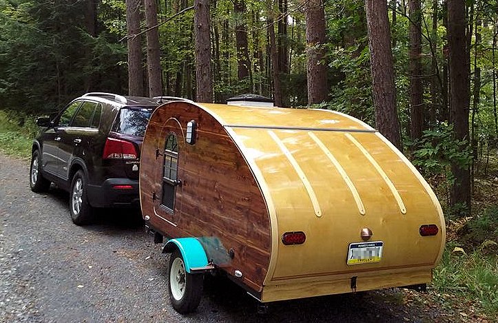

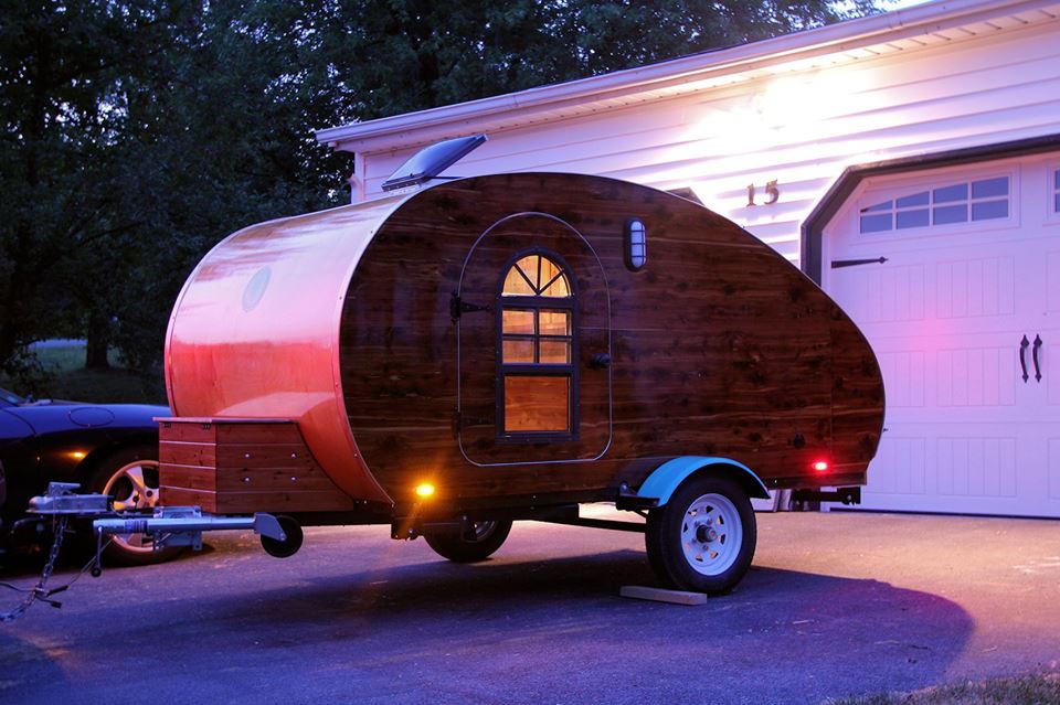

Our 5x9 woody took between 3/4 and 7/8 gallon of West System epoxy. Like previously stated- some waste in cups, brushes, drips...
Basically 3 coats of epoxy and 3 coats of spar varnish over that. This summer we'll put one more coat of Petit Flagship varnish on top and that should be good for a couple years.
My epoxy application method was disposable 3 inch brushes, then tipped off with 3" foam brush. The foam brushes from Jamestown Distributors are much better than the ones from big box stores. I tried 6" foam rollers but abandoned that method asap as it left too many tiny bubbles in the epoxy.
-Tom

I think you've chosen wisely. The wooden boat people would agree. Tom's photos speak for themselves (and I'd agree that a gallon would do a 5 x10 just fine).

TomMaj wrote:Our 5x9 woody took between 3/4 and 7/8 gallon of West System epoxy. Like previously stated- some waste in cups, brushes, drips...
From your description, I assume you did not use fiberglass? Does the wood on your sides have any texture or are they perfectly smooth and flat? Hard for me to tell in the picture. I wonder how well fiberglass would work on sides that have a bit of texture to them.
Your woody looks amazing. I really love your choice for the sides. I hope you make a build journal some day!
