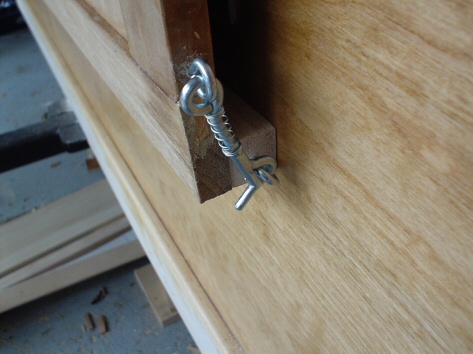

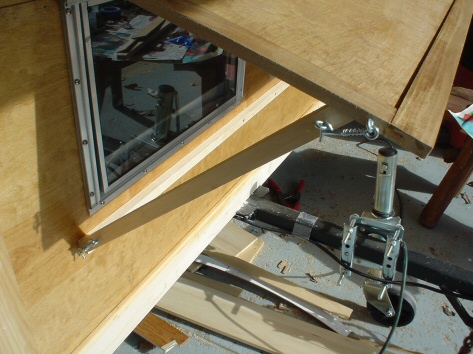

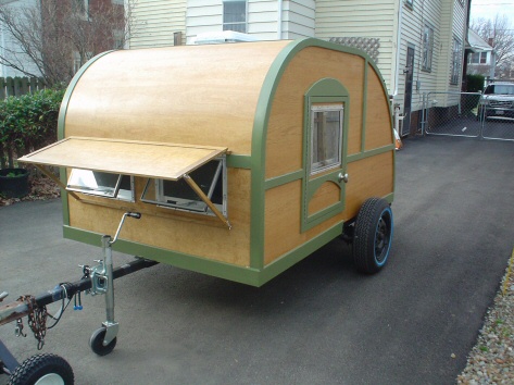

Postby b.bodemer » Tue Feb 13, 2007 9:57 am
I went with two of Grant's crank out windows in the front and then added a shutter/awning combo to protect them. Closed as a shutter when driving and then open as an awning in camp.

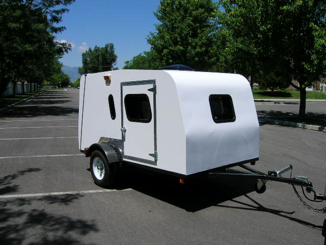

Postby sunny16 » Tue Feb 13, 2007 11:26 am
I put a front window in my trailer, too. It is a small fixed type and it is installed on a flat part of the trailer. I wanted to be able to see out the front. It makes the small trailer seem a bit more brighter (more light) and you can see out three sides in case of a bear, ha ha. I don't have a cover over it although it is an idea that I may add in the future. THere is always the chance of a rock popping up and breaking it. Oh, and all my windows are tinted which makes it nice out in the sunshine.
