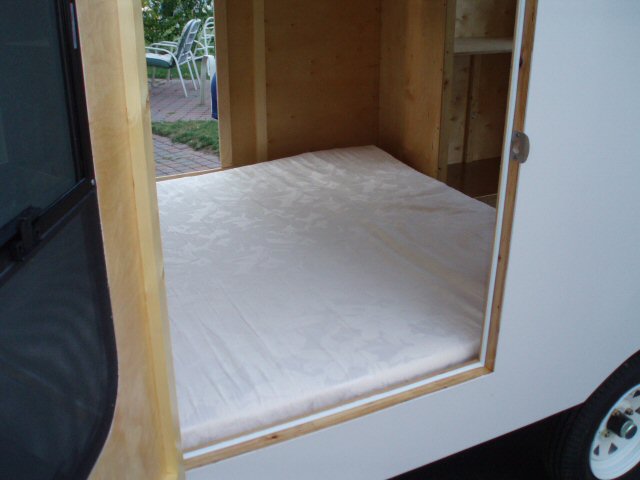

Postby mikeschn » Sun Apr 29, 2007 5:21 am
What Grant said!!!
That was my original plan for the Escape hatch, but we ended up cutting out the mattress for the wheel wells instead... Above the wheel wells I have 2" of foam instead of 6".
