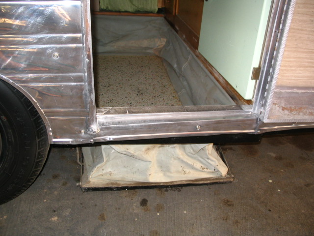

Postby cuyeda » Mon Sep 29, 2008 7:49 pm
navigator wrote:Cliff, any more pictures? Especially of the floor drop mechanism? And do you know how it works?
No, sorry, these are the only photos I have for this one. If originally it had a mechanism like Andrew's photo, this one did not seem to have it. Or at least from what I believe. I reached in to touch the flooring, and believe this trailer just had canvas type skirting around the drop floor. There could have been a rigid frame, but I did not explore the sides of it. The owner was not there at the time. The floor rested on the ground.

Postby Roly Nelson » Tue Sep 30, 2008 7:32 pm
Thanks for the great pics and info regarding the Trail Feather. The mechanism seemed pretty simple, but sure looked like heavy duty angle iron and operates very smoothly. The fellow that owns it is having a Vintage RV Gathering at Lake Casitas, CA, April 24 -26, 2009. His name is Craig Fraki, in Maricopa and the number on the flyer is 805-895-6977.
Perhaps he can give you a rundown on how it operates, or, if you are in the area, he probably will have it at the Gathering. This was really a well-kept trailer, all shined up and Craig was very proud to show it to me. I plan to attend his event, since it will be my first trip out in my newly reconditioned 6' 4" x 10' Kenskill Standy with the completely brand new interior

Postby navigator » Wed Oct 08, 2008 12:04 am
Craig's Trail Feather has been sold. He sent me a scan of the ad, and a shot of the drop floor. This is the other side of the ad seen above.
