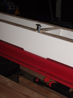

Postby jeff0520 » Sat May 19, 2012 9:54 pm
I drilled a shallow recess to allow room for the bolt heads, and ignored the other space
92130
92131
92132
I still need to drill that one a little deeper in the picture, but you get the idea :)

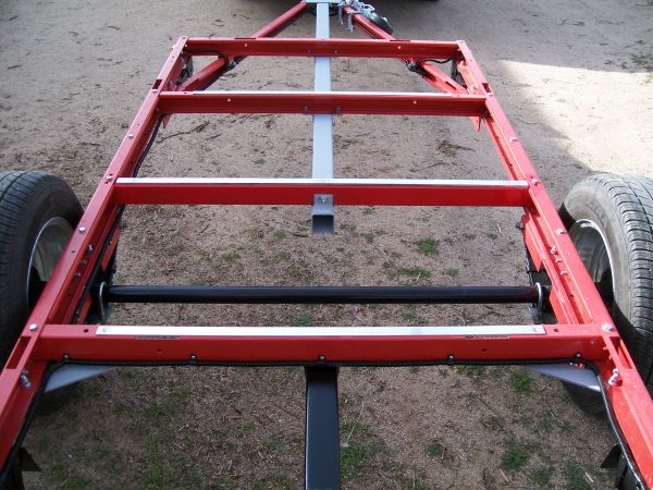

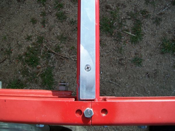

Postby down under tech » Sat May 19, 2012 10:18 pm
Hello Doc: This is what I did to cure this issue. I got three pieces of 1/8" aluminum flat stock and drilled holes through them and counter sunk the bolts used to attach it to the cross members. It was then even with the frame side rails.
On this picture you can see the aluminum stock spanning the top of the three center cross members.
P.S. Welcome to Teardrop Building 101... ;)
