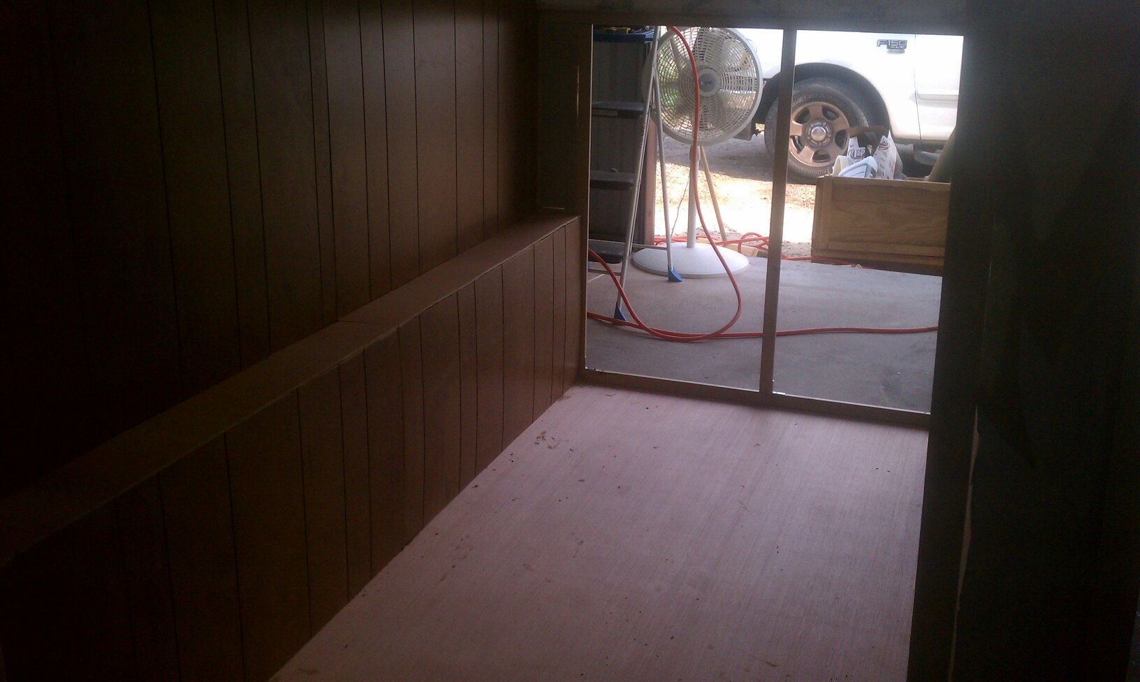

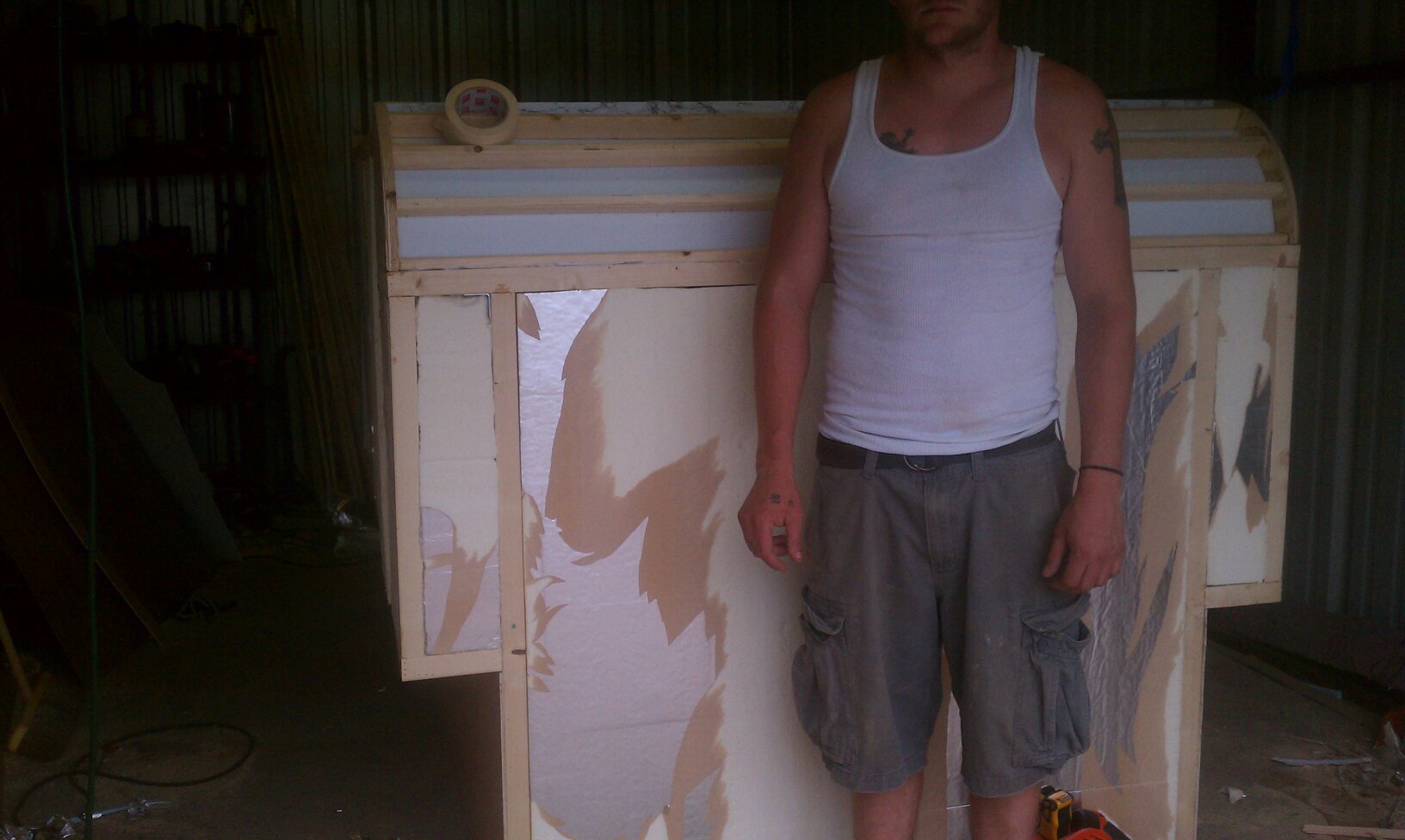

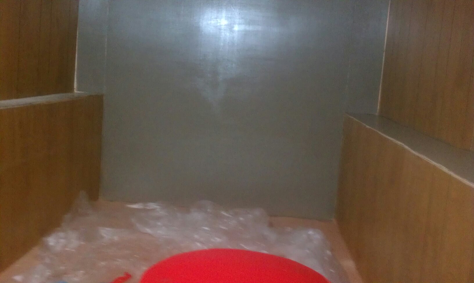

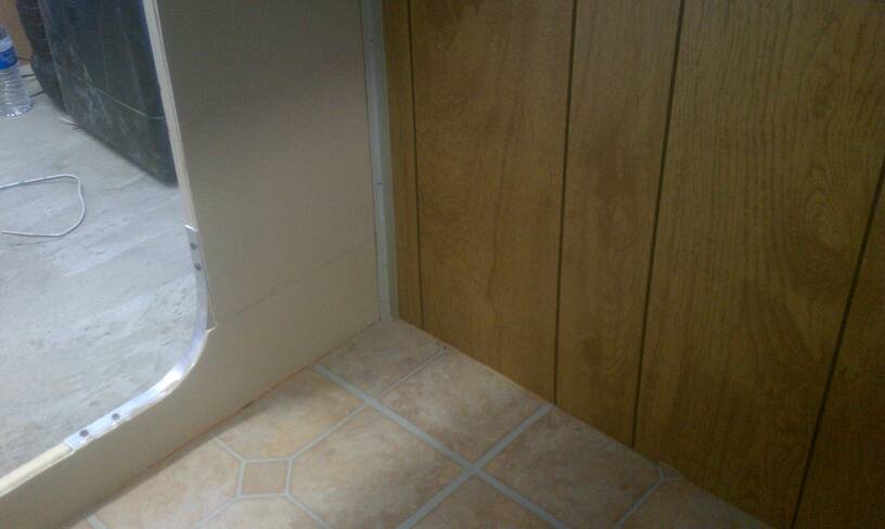

Postby linuxmanxxx » Fri Jun 08, 2012 8:16 pm
I'm about 80% completed so I'll put up a journal. Built everything using 1 x 2 framing 3/4"foam sandwiched between paneling/luan and formica exterior. Using my tried and true 3M 30nf fast bond contact adhesive all foam surfaces are glued as well a the framing. Build floor to 4 x 8 then 20" rise and then flare to 5 ft wide then 32" above this for bed platform clearance.

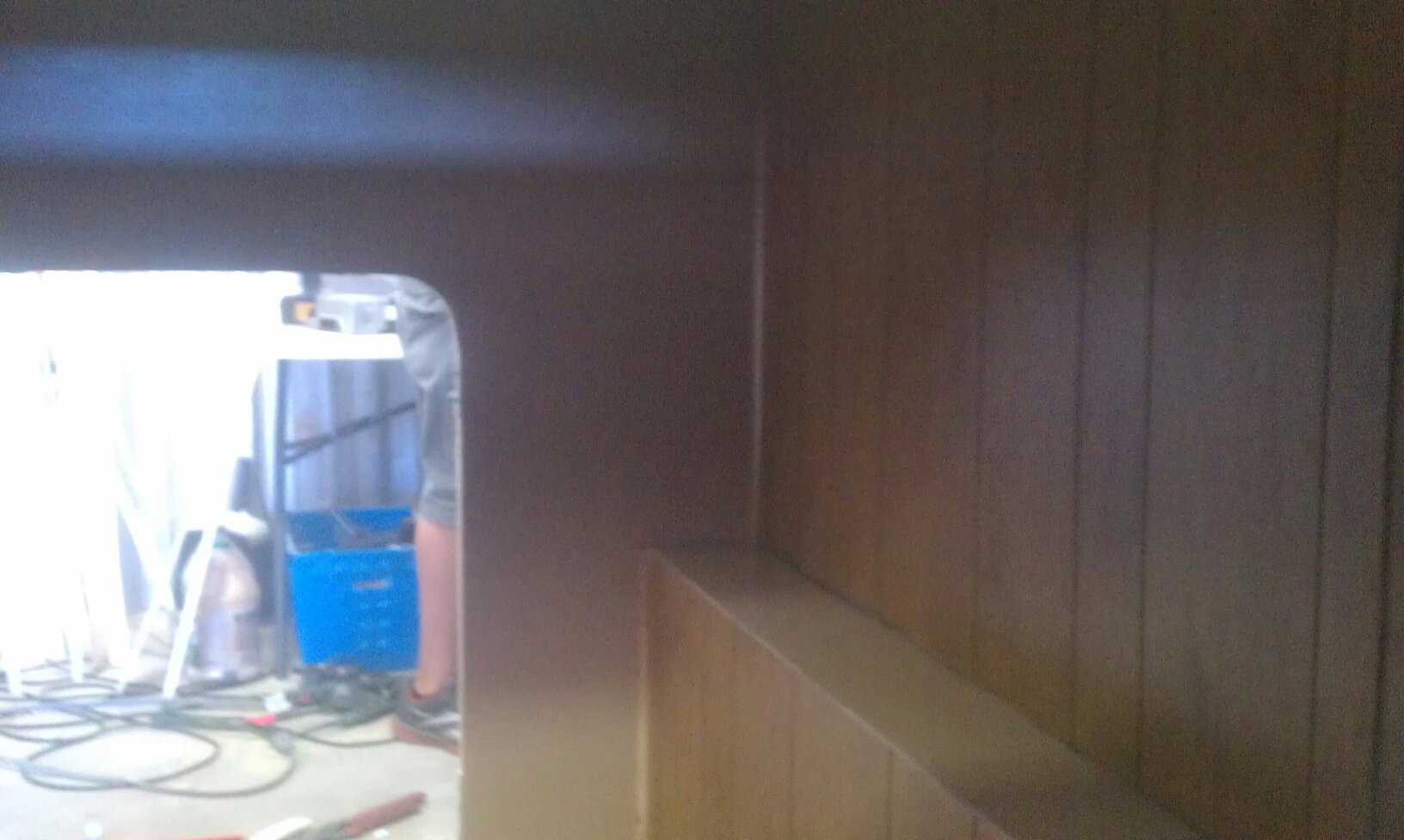

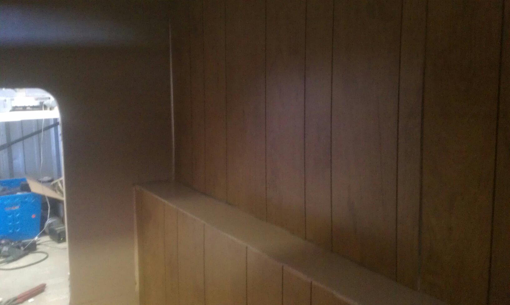

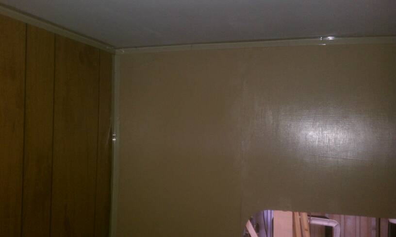

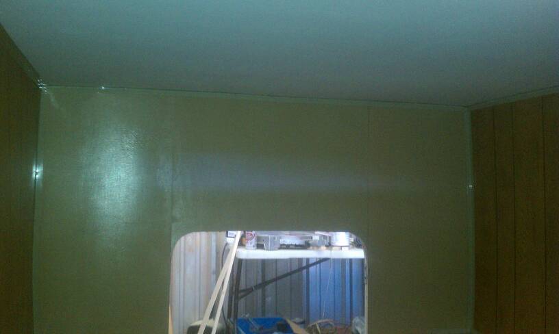

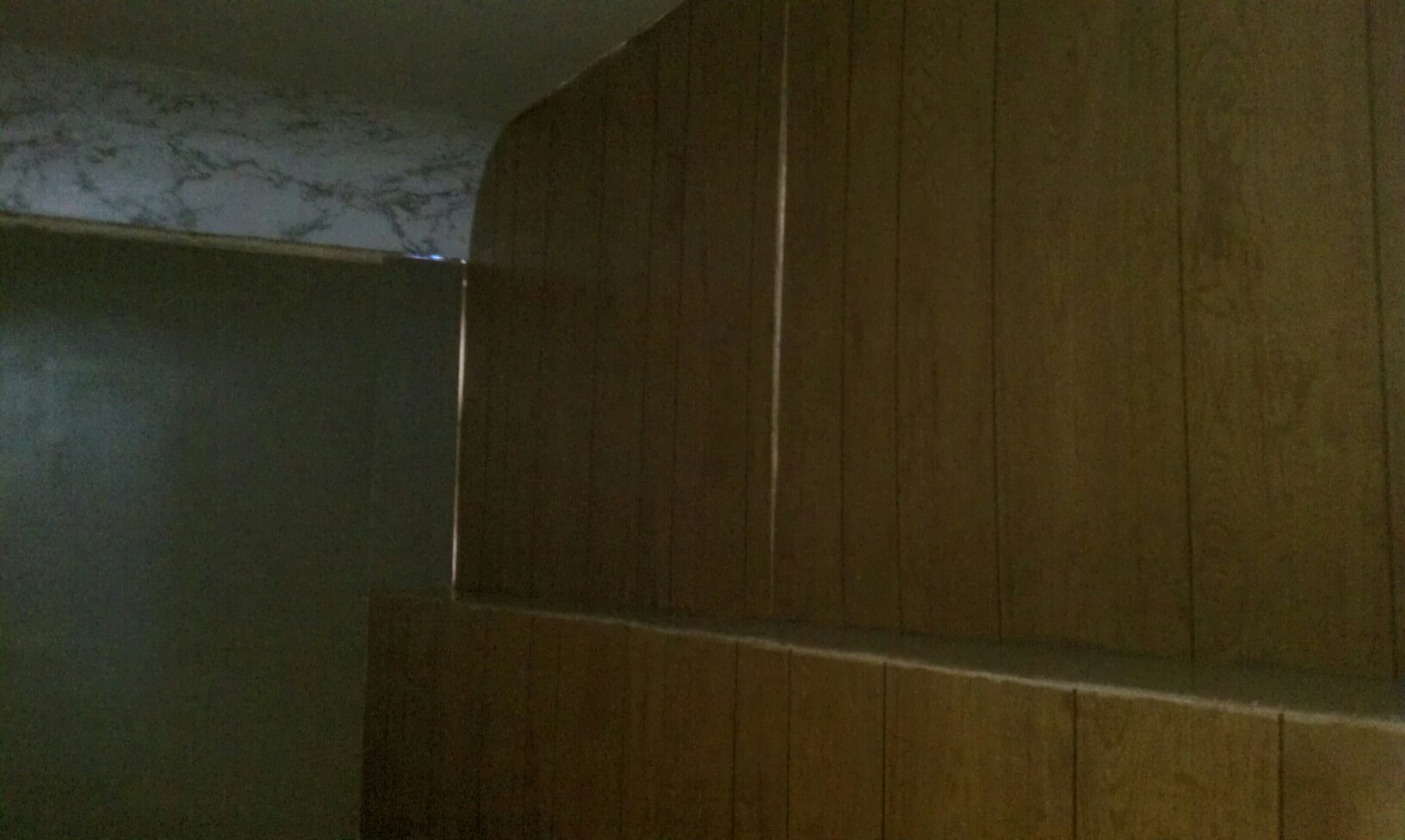

Postby linuxmanxxx » Fri Jun 08, 2012 8:18 pm
Interior almost complete about 30 hrs and 2 people working.

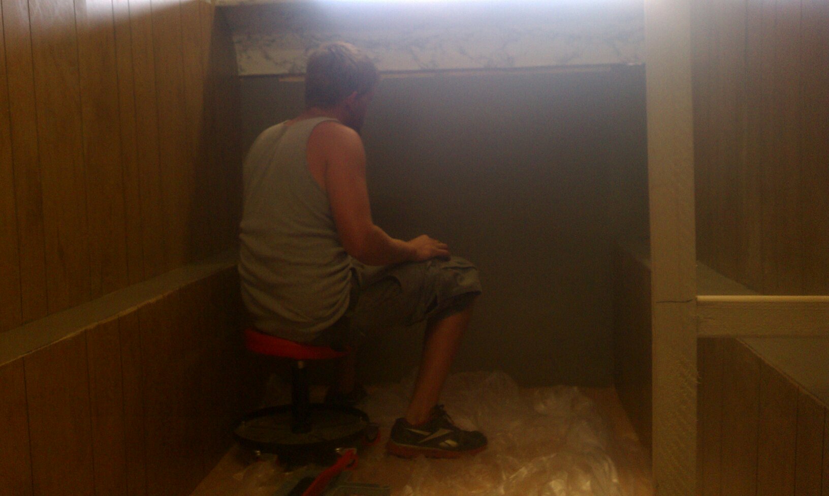

Re: Microcampers truck model

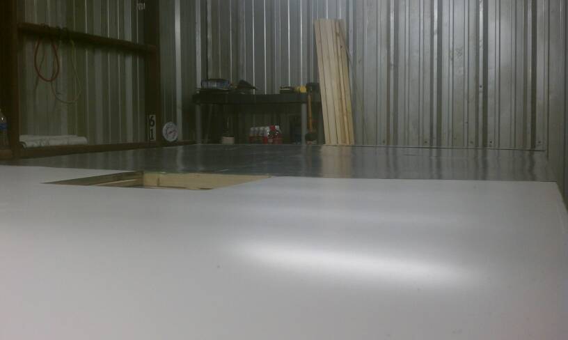

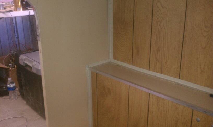

Postby linuxmanxxx » Tue Jun 12, 2012 12:48 am
I'll add a link later to a post in foam thread on how to frame the little guy style doors frank bear sells that is quick and painless. Just a little left on rear inside wall then paint it and then trim time and start the bed platform and them skin it and trim exterior.

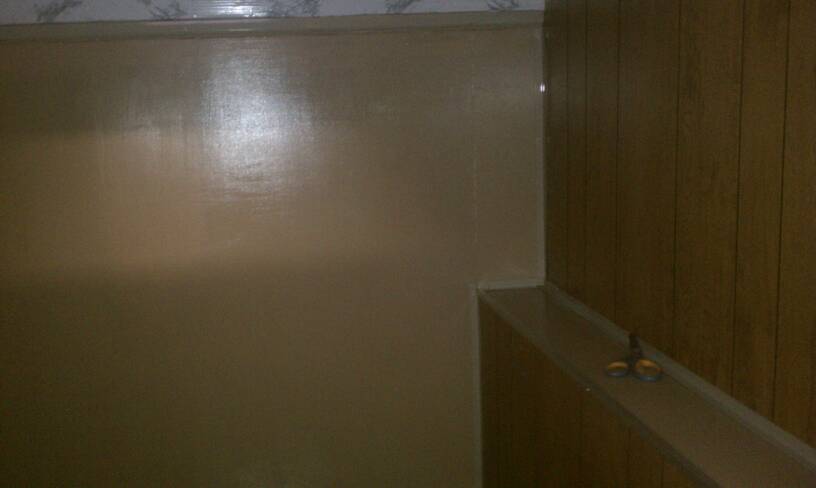

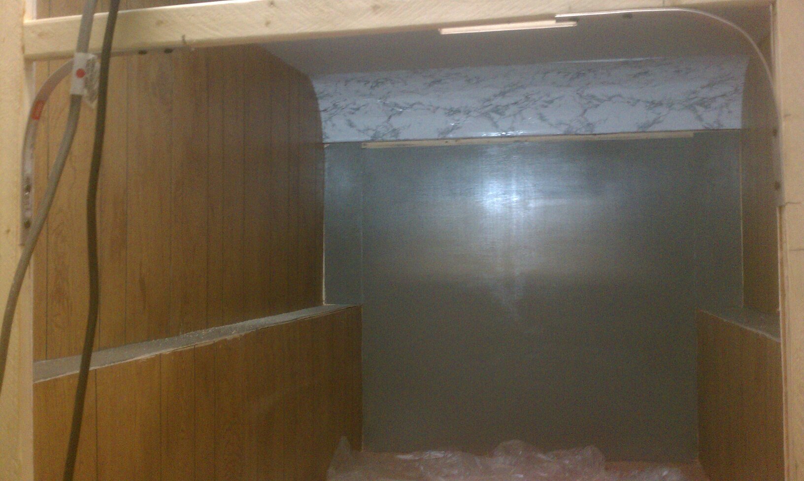

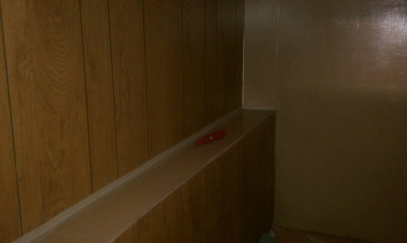

Postby linuxmanxxx » Thu Jun 14, 2012 4:17 pm
Interior almost completed and be skinning this soon.

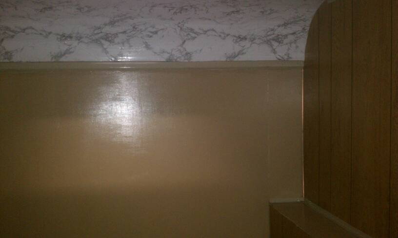

Postby linuxmanxxx » Fri Jun 15, 2012 4:41 pm
Had an epiphany for my trim and man it looks good and only 2.50 for an 8 ft piece and at hodepo.

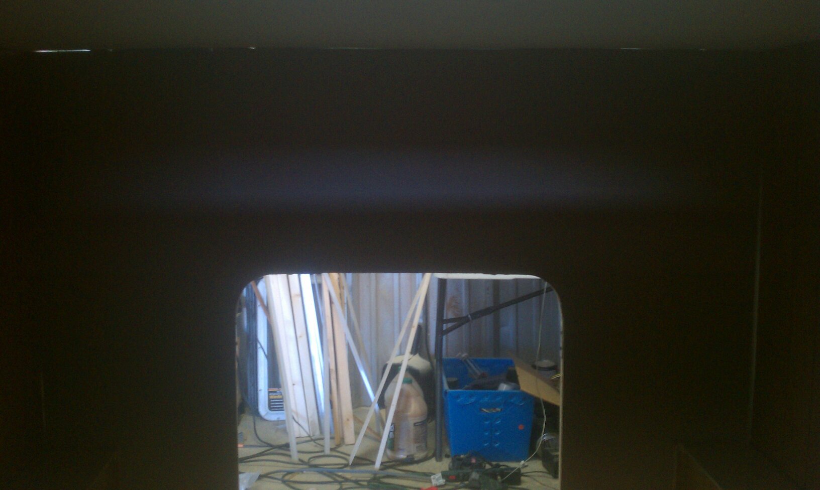

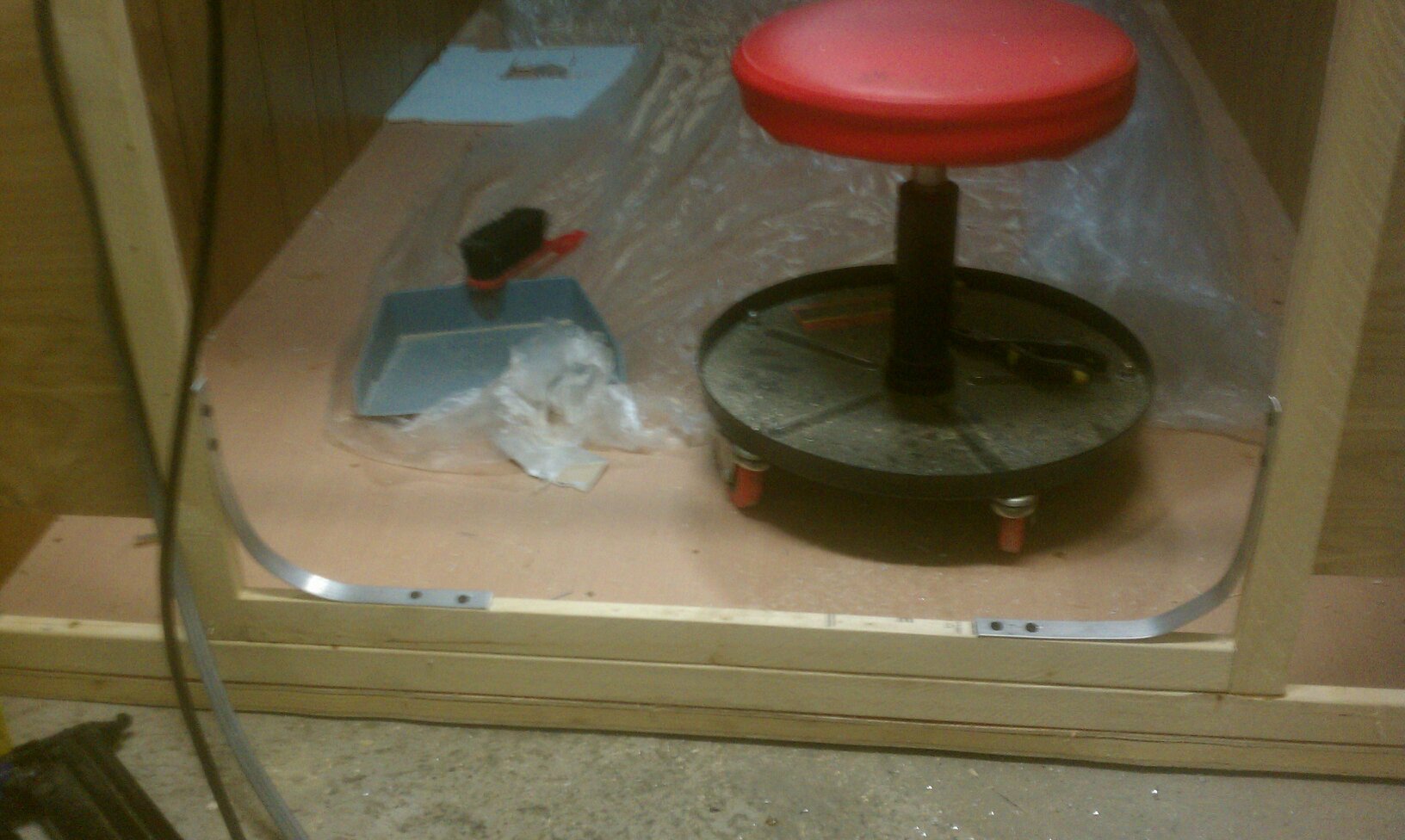

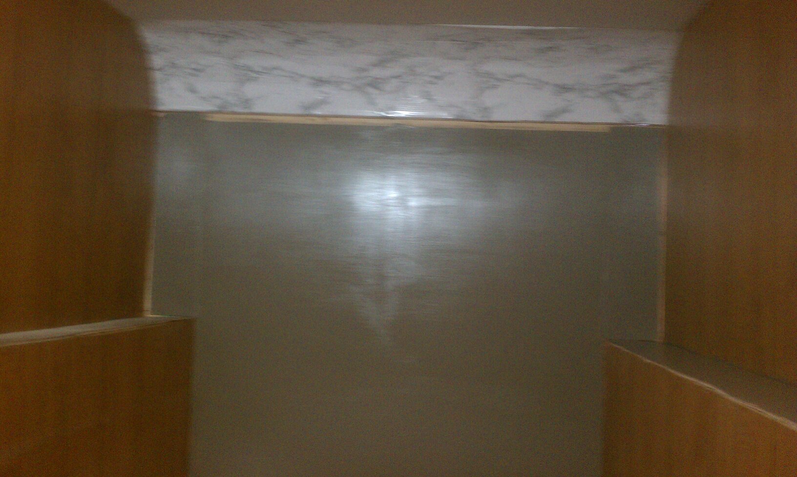

Postby linuxmanxxx » Wed Jun 20, 2012 3:19 am
Some more interior work.

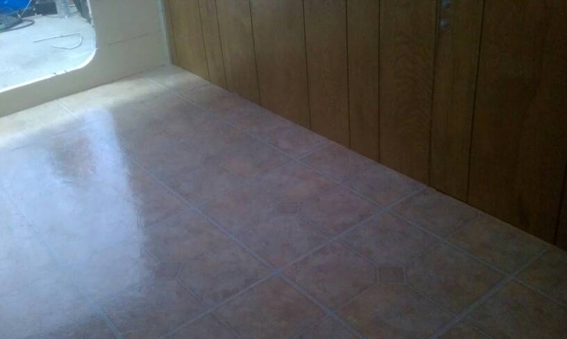

Postby linuxmanxxx » Wed Jun 20, 2012 3:29 am
More

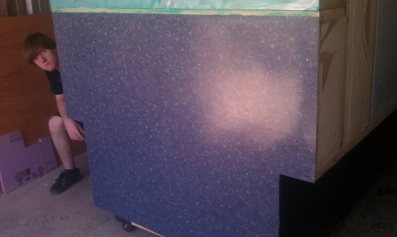

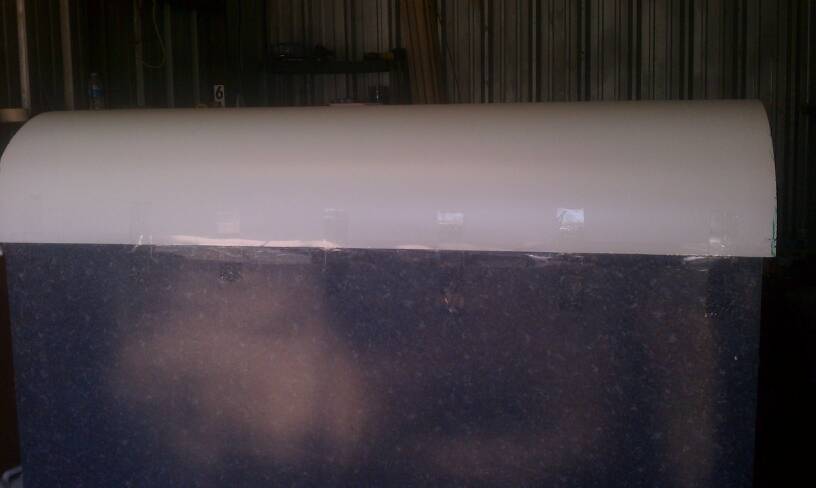

Postby linuxmanxxx » Mon Jun 25, 2012 3:55 pm
Started skinning today it's too hot so breaking and finishing this evening. Was 113 in shop.

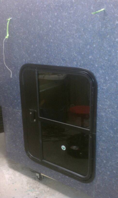

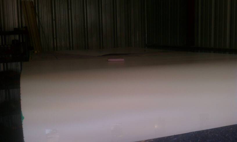

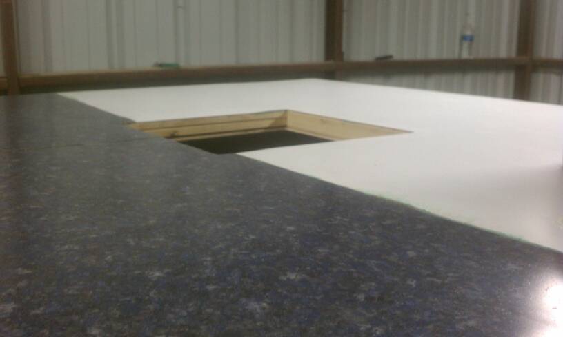

Postby linuxmanxxx » Fri Jun 29, 2012 3:36 am
The skin is finished and for is mounted in and now need to do outer moulding and trim. Can't get a full perspective picture until I get it out of the shop and in a truck which should happen in next day or two. With the flare to 5 ft, this has actually been more work than a trailer camper but it is looking fabulous for the intro build.
