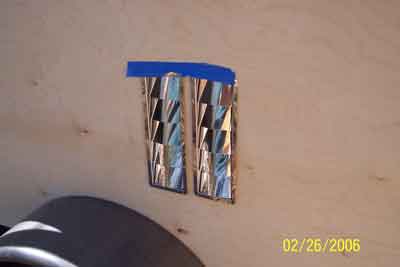

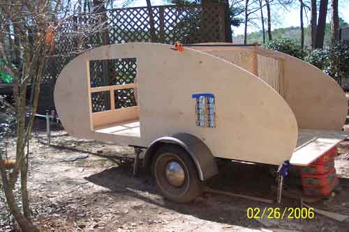

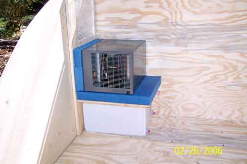

Postby Sonetpro » Sun Feb 26, 2006 4:09 pm
Artificer wrote:
I guess my plan for now is to find a way to shove the 5000BTU Walmart special AC into the trailer. If I can't run the Pet-cool on battery power, the extra $300 purchase price doesn't offset the convenience of easy mounting. More esoteric solutions are definetly not out, but I have to finish the trailer before starting the work on them.
Michael
Here's why I chose the Petcool. I am going to tow it with a Jeep CJ-7 so carrying it in the tow vehicle was out of the question. I wanted it built in.
After I got it I stripped off the handles and legs. It gave me a small 10 1/2 x12 1/2 x 16 package. It allowed me to install it in a bulkhead between the cabin and galley. Heres some pics.
