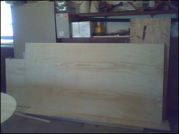

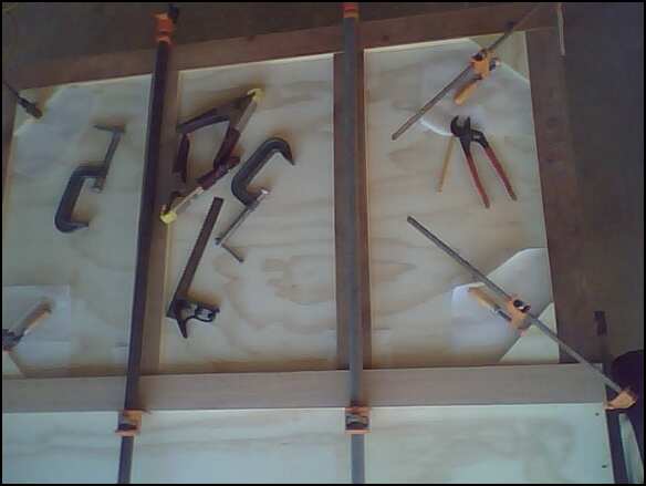

I have a floor! I biscuit joined the ply to make a larger sheet. It measures 108" by 58". When the walls are joined to the sides, it will be 60" overall width. I was really happy with the quality of 3/4" plywood I got for $30/sheet. It's just graded ACX but appeared to be AB and had virtually no voids. I went with 3/4" because it's larger than the frame and I'm not supporting it with a wooden subframe. Since it has to support itself (and the walls and roof), I decided to get some sturdy stuff.

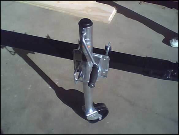

New tongue jack:

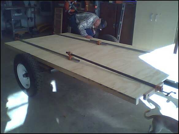

It's a family affair. My younger brother Drew stops by and I put him to work cutting biscuits.
Grandpa inspects the floor after we temporarily placed the deck on the trailer.

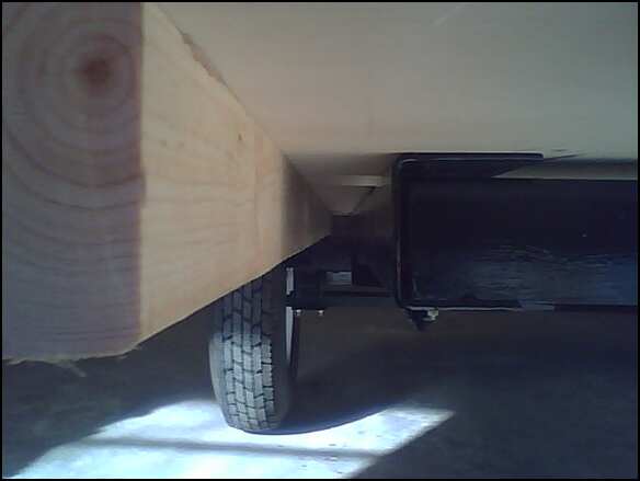

Underneath - view of the 2x2 nailer.

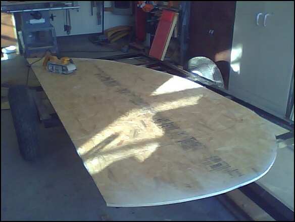

A little bit of progress to report today: The floor is undercoated and drying overnight before being permanantly bolted down. We used 5 cans of Mar-Hyde rubberized undercoating and I'm pretty pleased with the results.
We cut out a profile template out of OSB and tweaked with the belt sander. After marking out the bulkheads/doors/cabinets, it appears that everything will fit!

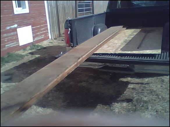

Went shopping at the free lumberyard (the barn loft). Found OSB for the template and good solid 1x12 to rip into cabinet framing later. Can't find lumber like this at the big box stores. Plus the price is better! :)

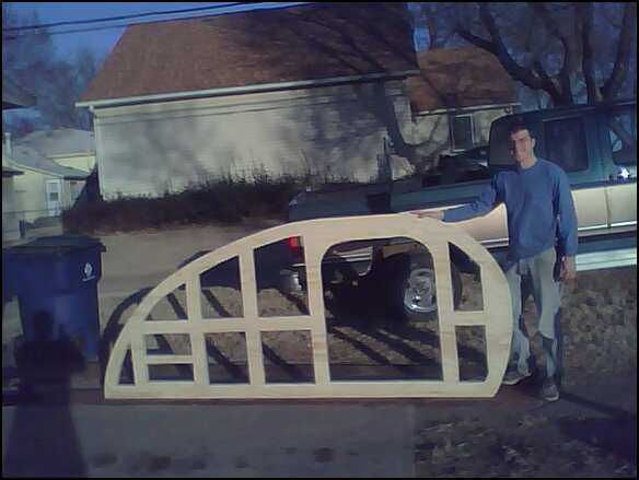

Hooray, a little progress today! We had a beautiful day here with sunshine and 60 degree weather. Sure beats the ice and freezing temps of just a few days ago. We got the sides made up. I took 4x8 3/4" ACX and biscuited on a small piece at the end to end up with this:
Then I took the template I previously made in OSB and traced it out on both sheets. A little jigsaw here and a jigsaw there and VOILA:
That lumber we found in the barn got put to use today. I ripped 3" pieces and used it to frame the front and rear bulkheads. This is the rear bulkhead. The cabin side cabinet will attach to this as will the fixed countertop in the galley. The lower cabinets will slide out and will not be attached to this bulkhead. The hatch will be hinged on the top piece (bottom of picture) and so I made it out of full dimension 1" oak to better carry the weight.

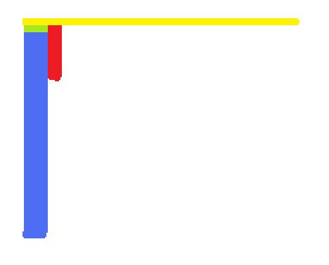

******************Question*********************
I haven't notched out the side profile for the hatch. I will be using a plastic piano hinge. Here's what I'm thinking:
This is as if looking at the hatch construction from the rear (cutaway).
    The blue is the sidewall (total 1" thick)
    The red is the hatch rib
    The green is the gasket
    The yellow is the hatch skin (two layers of 1/8" ply)
    There will be aluminum angle on the side hanging over the edge (not shown).
My roof is only going to be one layer of 1/8" So, if I figure that one layer of 1/8" on my hatch can stick up, it'll be flush with the rest of the roof. That leaves me 1/8" of ply and ??? of gasket to cut out a notch for. I'm thinking 1/8" for the gasket as well, giving me a 1/4" notch. Does this make sense? Am I thinking this through right? Thoughts will be appreciated!!!

Postby Miriam C. » Fri Feb 06, 2009 10:47 am
Brad
:o Sorry your question about the hatch got skipped. I think an 1/8" hatch seal will be harder to work with. Remember that you want the hatch seal to compress 50%. Now if you have a 1/8" seal that you like then make your cut 3/16" That is 1/8 for the skin and half of 1/8 for the seal. :thumbsup:
Postby bbarry » Fri Feb 06, 2009 11:00 am
I was thinking of using Grant's hatch seal. It's .4" high and I seem to remember him posting somewhere saying it compressed down to very little. I was figuring 1/8" for the compressed height of the seal (not the total height). Maybe I need to figure a bit more.
