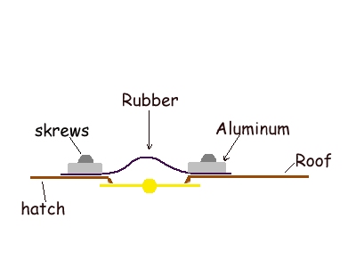

Rubber or silicone seems to be the seal of choice for Hurricane hinges.
Mike Schneider (Founder) wrote:The most common way to seal a hatch is to use a Hurricane Hinge, weather stripping where the hatch hits the sidewall, and angle to act as a sort of a protector..
Mike Schneider (Founder) wrote:Getting the hatch watertight is easy. Use Grant's hurricane hinge, and extend it over the edge an inch on each side. Then use as much foam weatherstripping on the side edges and it takes to fill the gap. And finally, build a rigid frame for the hatch, and draw it up tight with latches.
There's a lot of material in the forum on this... just do a search. If you have a problem finding a specific detail, just holler... we'll help you find it...
mike...

Note: Image
Jack AKA (Madjack) talks about proper installation of Hurricane hinge:
I made my hatch 1/4" smaller than the sidewalls, so that's 1/8" space on
each side for free hatch movement.
To keep the hurricane hinge from sliding...1) cut the hinge so that it is 1"
longer overall than the width of the tear...this will act a deflector to keep
rain water from running into the galley 2) on the hatch portion of the hinge,
cut it off so that it is 1/2" shorter overall than the body portion 3) drill a
hole in the body portion of the hinge barrel 1/8th" from the ends and run a
small screw down into the hole after mounting is complete...this will keep
the hinge from sliding and from leaking.... ...also a piece of 1" x 3/16(or
1/4)" closed cell weather stripping, a couple of inches long put in-between
the closed faces of the hinge will help keep water out...we have done this
and have had no issues with the hinge...
...once again...cut the hinge AT LEAST 1" longer than than the body is
wide...this will give you 1/2" overhang on both sides to act as a rain
deflector...cut the hatch side a 1/2" shorter than the body side...this will
give you room to insert a screw into the body side barrel(both sides) to
keep the hatch hinge centered and prevent it from sliding side to side....
p.s we used insert edge molding and put an insert in it and the hinge...it
should be available from your local RV dealer or online from places like
RVsurplus...
