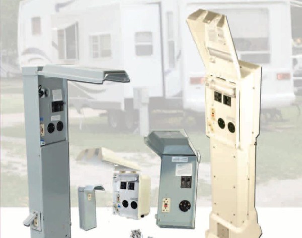

Many people ask what is the power panel like at campgrounds?
What side of my trailer should I have power come into when I
make my inlet connection?
Answer:
See what the power panels at campgrounds look like here
Campgrounds have 15- 20 amp, which is the standard household plug. they also have 30 amp, and a 50 amp twist lock, all 110-120 Volt. With an A/C installed (5000 btu) most trailers are not going to pull more than 15 - 20 amps. Unless you really load up on the electrical side. I just would not cheap out on the shore power cord.
1) 15-20 Amp 110-120V
2) 30 Amp 110-120V
3) 50 Amp 110-120V
More details on RV recepticals and 120V 20,30,50 Amp service available at most campsites here:

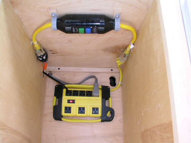

Question:
How can I be sure the power from the campground is wired correctly
and there are no grounding issues especially testing for GFCI?
Answer:
GFCI Tester that might be carried to test shore power before
you hookuP to the your trailer:
GFCI explanation by Bruce:
DO It yourself Step By Step instructions for GFCI plug instillation

Internal power panels, wire gauge questions & ground fault circuit (GFCI)?
Answer:
There are many setuPs here on the forum for power panels.
Read some of the forum threads and then ask questions.
BRUCE(bdosborn) GFCI and circuit breakers
provide different kinds of protection and compliment each other.
BRUCE(bdosborn) Discusses wire gauge and fuse sizes
