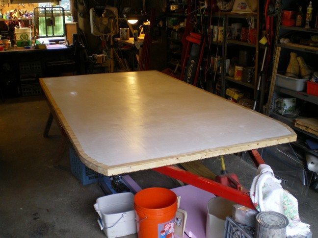

Well, finished off covering the bottom yesterday. Waited for the glue to dry overnight and cut the front curves in this afternoon... went to home depot, and got some Henry's roof coating, and went crazy...
Just a side note... using the frame as the work table really fit the bill... very sturdy... after floor dries and I flip it, will lower it to milk crate height and continue building walls.

Postby Arne » Tue Jun 12, 2007 4:21 pm
The floor has been flipped. I painted the top with 2 coats of kilz.. on the first coat I sprayed a light coat of florescent green paint (so I could see what I hit with the second coat...)
Tomorrow, I start the left wall.. I don't have it all planned out, but I'm hoping it will come together.. it damn well better, or I'm in deep doo-doo..
I've updated http://www.freewebs.com/aero-1 with this pic and a bit more explanation...
