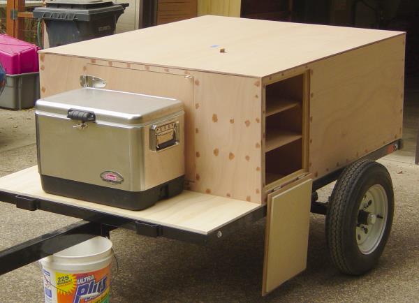

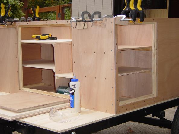

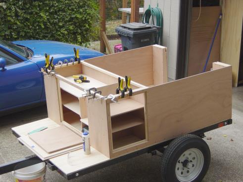

Here is a picture of testing fitting / sizing the shelves for the front and side compartments.

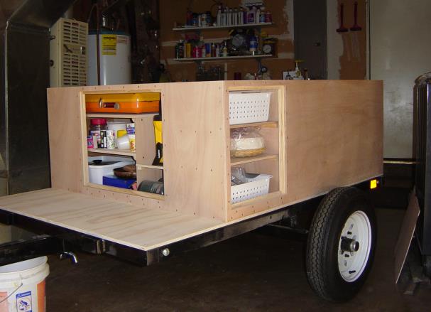

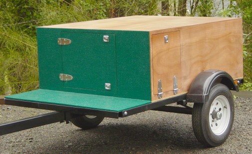

Here is a picture with the compartment doors hung.

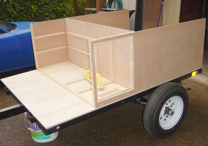

A few compartment build pictures.

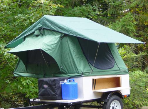

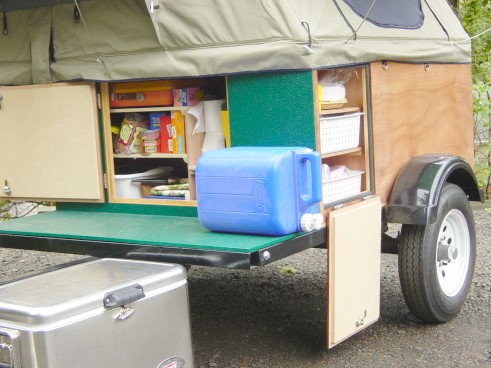

Here is a picture of the mockup with a tent unit on it.

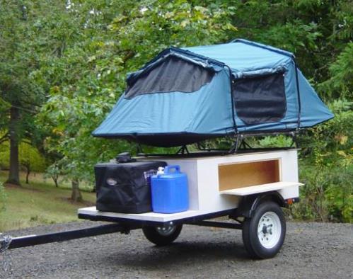

jeeper92, the tent bolts to the top of the trailer box with four bolts. When closed it's the same size as the box top. When opened it's 94" x 55".
Here is a picture of the mockup for this trailer with the other tent we have on it. At 50 lbs its half the weight of the green tent and uses a trampoline like fabric floor instead of a solid base like the green tent.
Thanks for the positive comments on our new trailer. As some have commented, these are popular with the expedition / off-road crowd. This particular trailer could be built off-road ready, although I focus on lightweight versions aimed at folks driving smaller fuel-efficient vehicles. Using the blue tent below, this trailer setup weighs in at 375 lbs. For light-duty off-road, add a couple of hundred pounds for a beefier frame, bigger tires and thicker plywood. For hardcore off-road like the Rubicon, you would need to do a fair amount of fiberglass tape / epoxy reinforcement to the corner joints.

When I did a weigh in last night, it came in at 343 lbs with the "blue" tent unit. Even when loaded my Subaru will hardly know it's there.
