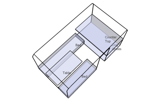

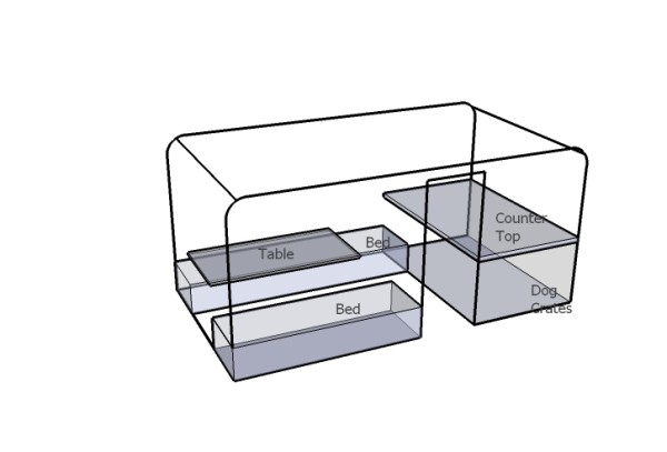

Here are some sketches of the floor plan

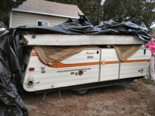

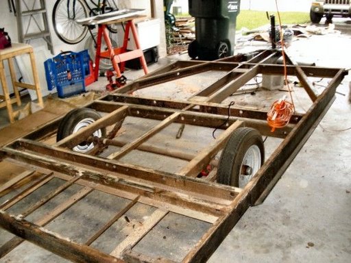

I started out with a 1979 Starcraft pop-up camper that I only paid $50 for. When I was done stripping it down, I took the aluminum to a scrap metal place and got $53 for it.
Here's what it looked like once the demo was done. The frame is 6'3 by 10'7".

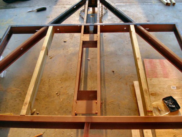

I added some extra supports in the frame because I didn't want any type of subfloor in order to keep the over all height down.

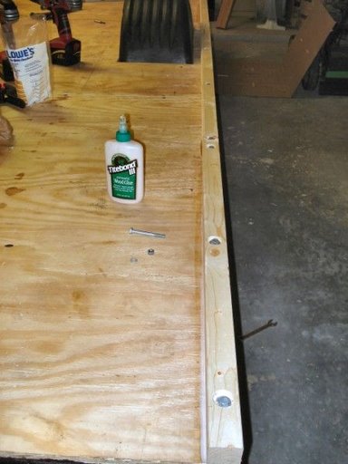

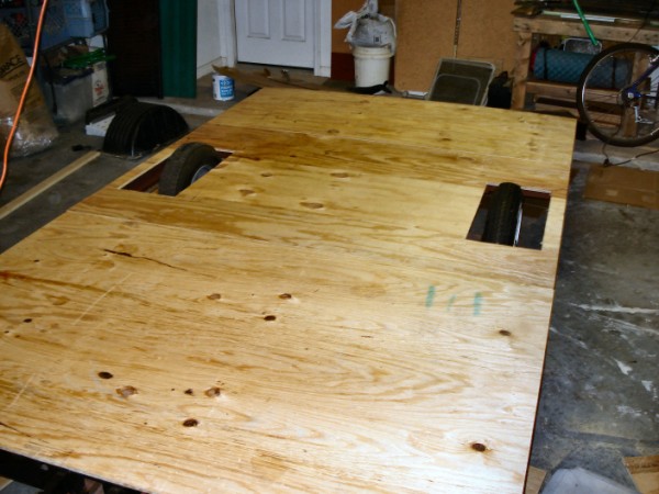

The floor is 1/2 ply screwed directly into the frame just like the original floor. There are 3 sections butt jointed together over the cross memebers of the frame. I put 3M Marine sealant in between the joints.
I attached a 2X2 cleat along the floor. This is what will attach the walls to the floor. The walls will overhang the floor 4 inches to cover the frame.

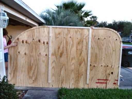

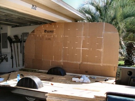

In order to get the maximum height and still fit in my garage, I made a cardboard wall and cut out the profile while the trailer was in the garage entrance.
Then I laid the cardboard over 3 pieces of 5/8 ply and traced it on.
The framing pieces on the sides are 1X2s. The pieces in the middle over the joints are 1X3s. The curved pieces are cut from the 5/8 ply.

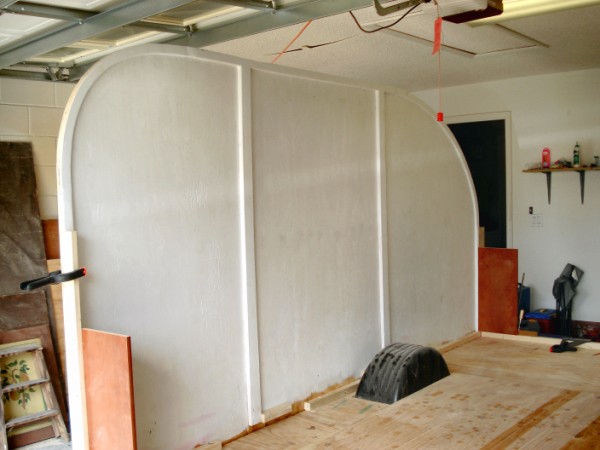

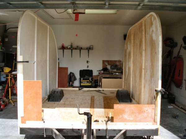

After boths walls were done, I stood them up and sanded them until they matched each other.
That's it for now, next step is attaching the walls.

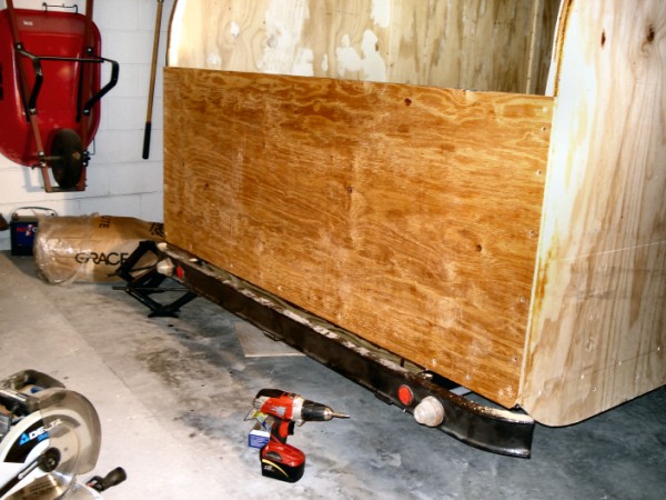

Postby Michele » Sat Feb 23, 2008 7:54 pm

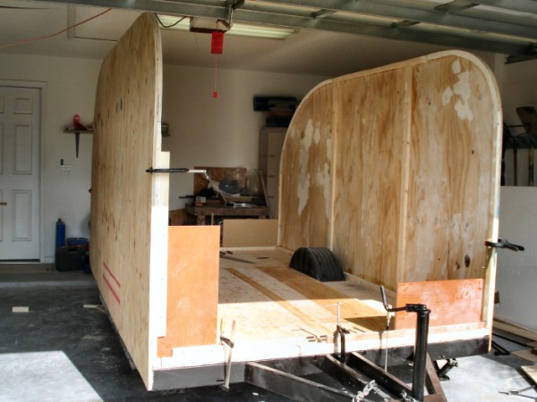

I got my walls attached today. It wasn't nearly as hard as I thought it would be. I used 2 car jacks to lift them in to place. And two friends to keep the walls steady on the jacks while I screwed them on.
I didn't cut out the door because I was afraid of the wall being too flimsy to deal with. I will cut it out once the front wall is attached.

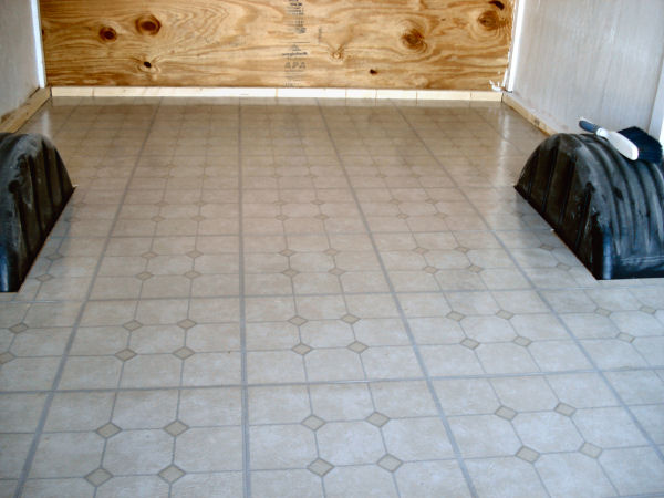

Back wall is on
And vinyl floor is done

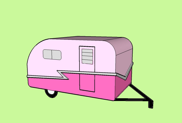

After drawing it in Google Sketch Up, I think I have decided on how I want to paint my camper. Shastas are my favorite vintage trailer and that is what I had my heart set on buying before I realized that it would not fit in my garage. So I'm pretty sure I'm going with the classic Shasta Z paint job.
Michele
