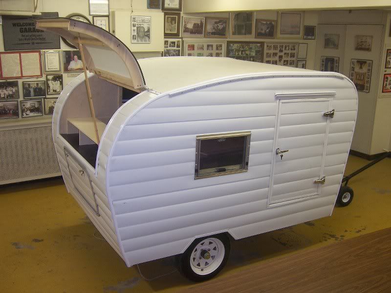

Postby Steve_Cox » Sat Jul 19, 2008 7:48 pm
Continuous harsh environment hinge from McMaster.com
Just another installation with 2+ years and no problems.
Steve
