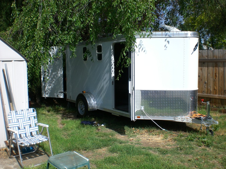

This weighed 1,250 pounds gutted (no spare tire). I added about 800 pounds with the interior done in wood (including a spare tire, solar panels, big 12VDC battery, steel futon, camping gear, food, clothes and rear, exterior galley box). It's all aluminum except the steel axle and steel wheels. It's called a 7-wide 12 footer, but it's really 6 ft. 7 in. wide outside x 14 ft. 6 in. long inside x 6 ft. 2 inches high. It was fun to do and fairly easy.
Before:
After:

I picked up a 6x12 Pace cargo trailer last week so that I can do my own conversion. I noticed that you used two smallish windows mounted high on the curbside. This will give you nice privacy and let some light in. Having placed the windows in this fashion, are you happy with the result....do they let in enough light? Do you feel the need to be able to see out the windows while seated on the futon?

2. Tows like a ghost. (Barely know it's back there.) At under 7 feet wide, don't need rear view mirror extensions. Can only see the trailer's fenders in the side mirrors of full-size van.

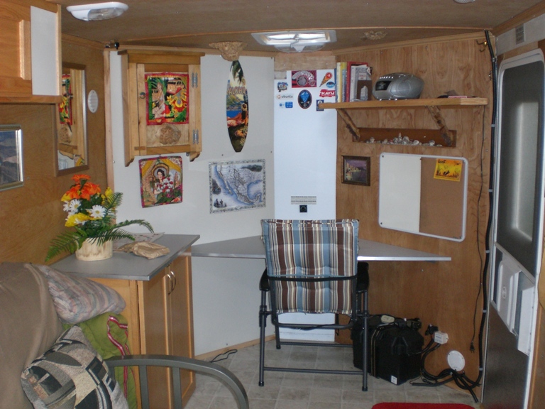

3. 12 inch (w) x 18 inch (h) windows fit perfectly between wall ribs (studs). Got them on eBay. Yeah, it's enough light because the 18 inch x 18 inch bubble skylight (inoperable) directly above the futon lets in 5 times more light than a window on a wall of the same size. One looks up at the sky, the stars or the trees when seated or in bed. Also, there are pull-down, car style sun shades on the two windows for privacy.
4. I highly recommend V-nose trailers for the extra interior space and for the reduction of wind resistance. And I highly recommend all-aluminum trailers. There are only a handful of manufacturers. I like Featherlite, Aluma or Worthington aluminum trailers. If I had it to do over again, and with deep pockets, I'd special order one with a V-nose AND a V-tail.
5. Sold the teardrop I made and used 4 years for $4,500. Bought the Featherlite for $4,250. Both are 12 feet long. Guess which one is lighter and has 8 times the functional volume.
6. Two small solar panels (unbreakable, Uni-Solar) on roof charge the battery thru a charge controller. LED interior lights draw almost no current. (All bought new on eBay.)
7. Crank-up white skylight/vent in front over desk lets the heat out when doors are closed, while side windows open and have screens for some cross ventilation. Usually only open one of the barn doors on rear. Gate-style, sliding latch at floor level holds the other closed from the inside.
8. One inch foam insulation in walls and ceiling.
9. Closet holds porta-potty, coats, broom, hiking stick and supplies on shelf.
10. 30-second, preferred method of cleaning upon arriving back home: electric leaf blower. (Only way to get the pine needles out of the screen of the crank-up vent as well.)
11. Seventh RV I have built/converted.
12. 3/16th (or metric equivalent) birch plywood on walls and ceiling finished with my mixture of bees wax and lemon oil. Smells sooooh good.
Front interior photo:

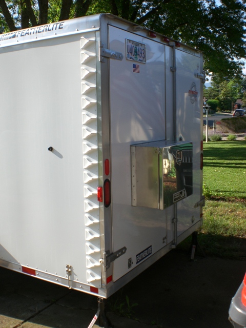

Does it have any kind of a galley? Whats the back end look like?

Postby Prem » Sun Aug 24, 2008 8:25 pm
It looks like this:
Prem
P.S. The back half of the aluminum box I sawed off. The other half is now the slider box under the futon for clothes. It has a drawer handle and there are felt strips on its bottom so that it doesn't dull the floor.

Postby Prem » Sun Aug 24, 2008 8:58 pm
The rear:
