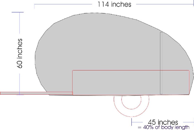

- It still recycles my old tent trailer, which had a 84" body, with the axle bang in the centre (the red line shows this for reference)

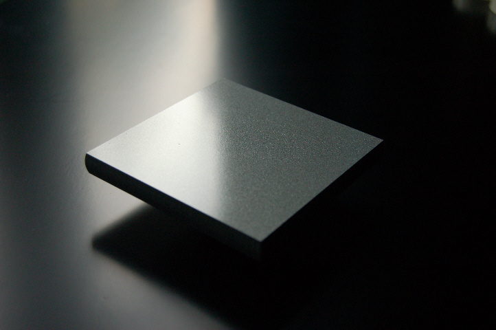

Uses 10 x 5 sheet for the sides (have found source of Birch ply, and also investigating TRESPA)
Extends the body forward, leaving the axle at 40% from the back
Will accommodate me at 6'4" I think
It is based on the Grumman 2 profile, which I think is very elegant, but will have a slightly raised bed to sit over internal wheel arches (because of the donor chassis). My only worry is that the tongue is quite short (he said doing a quick simutaneous translation from the English, and there's probably no room for a tongue box).
Here's a link to the design http://tnttt.com/album_ ... c_id=42197
