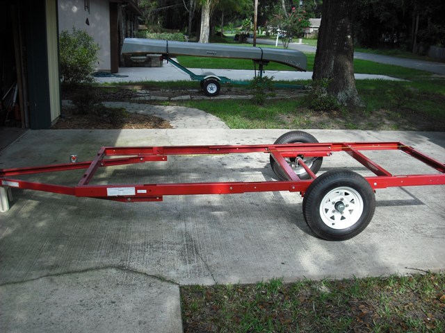

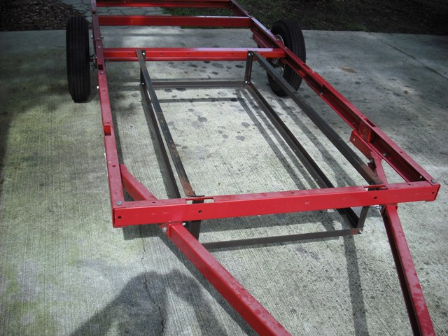

I've had this Harbor Freight 1740 Lb trailer sitting around for a while, so I've decided to lower and stretch it and build a mini-gypsy caravan. I don't really have any written plans, but I've been thinking about it for a while. Here's the frame stretched to 117". I'm going to make the footwell out of bed frame angle iron, and keeping with the bolt together frame concept, it will be bolted together too. The plan is to be able to get it in and out of the garage with the wheels on, and still have 6'2" head room.

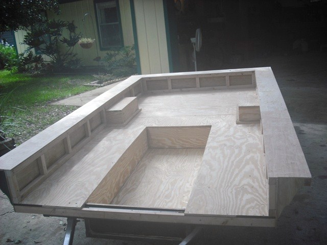

I'm looking forward to seeing what I build myself, so far I've changed my mind a half dozen times about it. I've got the foot well frame bolted together, just need to add a couple of stabilizers to the sides. I'm going to use the tongue as a frame for the front porch. You can't tell by the picture, but the ground clearance is about 9 inches.

How much ground clearance is that footwell?? looks like a "sparker" to me :roll:

starleen2 wrote:How much ground clearance is that footwell?? looks like a "sparker" to me :roll:
Ground clearance? mentioned in the above post. (9 inches)
Sparker? Thanks for the vote of confidence. :lol: I have faith that it will be fine. But if it isn't, I can put the axle back under the springs instead of over them :thumbsup: (a contingency plan)

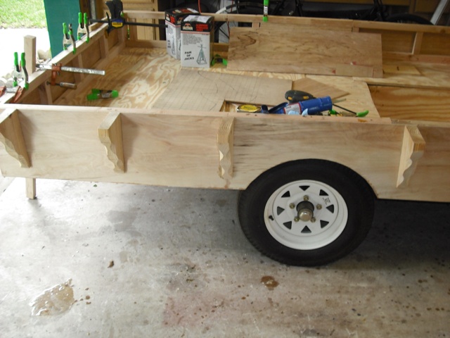

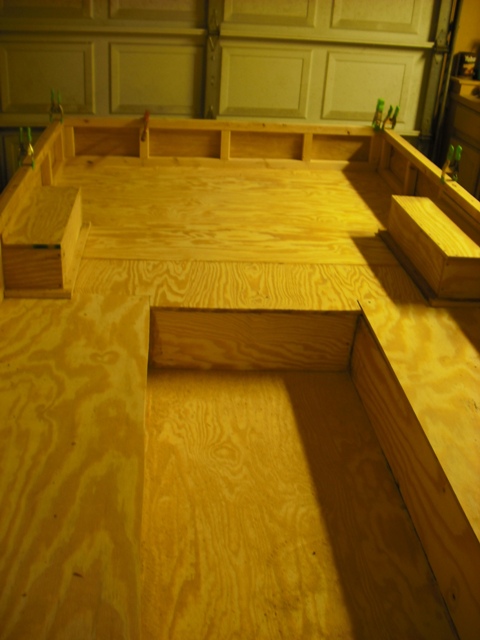

Postby Steve_Cox » Sat Oct 18, 2008 4:01 pm
Floor is on, the short side pieces are just clamped in place so far, this will form the ledge for the walls. Some vardos or gypsy wagons were called a ledge because the bottom formed a box that had a ledge built out over the wagon wheels, I am making a ledge so the bed area can be across the back of the trailer. I'm getting to the part where I spend more time in the chair looking at it than making sawdust.:thinking: Image
Steve

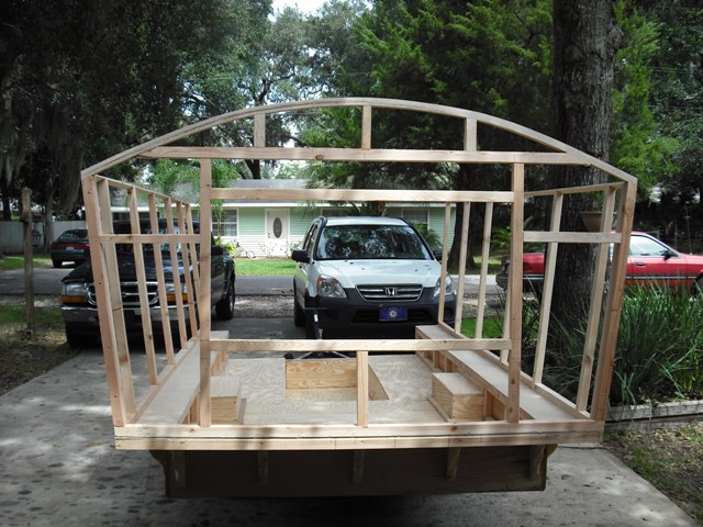

Postby Steve_Cox » Mon Oct 20, 2008 12:00 pm

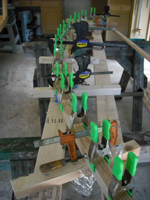

I started the framing for the walls. The first top bow was several layers of 1/4" plywood laminated together with Titebond III. After the 1st top bow, I made a jig to match it to make the rest, they are going to be several pieces of pine laminated with epoxy, because it cures faster than the Titebond III dries. I added an inch of bow at each end to allow for spring back, It was just a guess, so I guess I'll know when the first one comes off the jig how it turns out.
Steve
