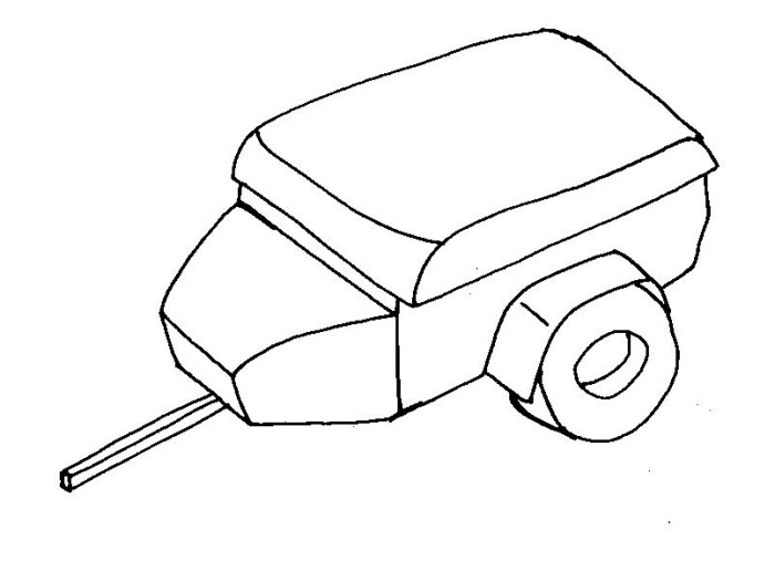

It�s time to move from the sketch stage to the build of a new trailer idea of mine. There are a few themes that have bubbled to the top from the feedback on the Explorer Box. First, it looks like a box, hence the name Explorer Box. Second, I don�t want storage shelves, I�d rather use removable storage box to organize my stuff.
For this one I want more of an off-road look to it and of course be Tent Topped. It�s designed with a main rear storage area sized for Arko-Mils lidded storage boxes and a nose box storage area.
Here are sketches of the basic idea.

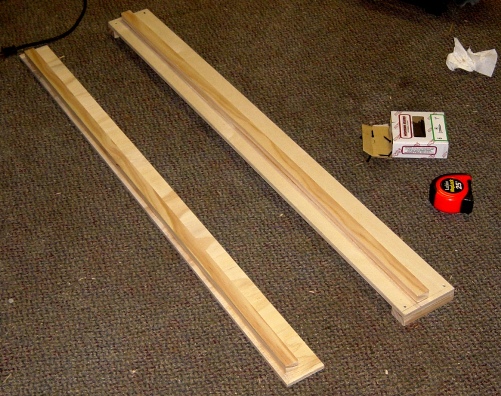

I began by cutting out the floor. The nose box sides have a 60 degree angle and are set in 1�. The 60 degree angle corresponds to the tongue a-frame braces. Next I added the corner blocks to the floor to which the walls will attach.

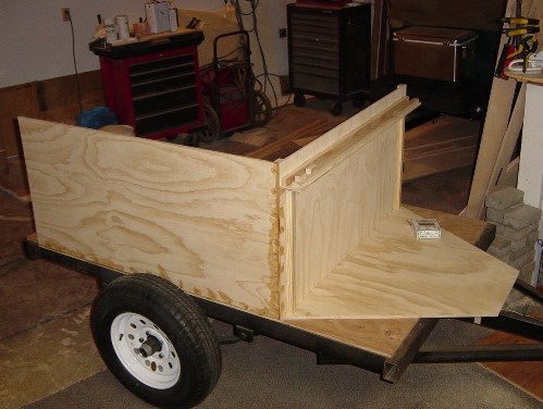

I added the front wall. Before attaching it, I added a portion of the overhang structure. I made the walls 24�, maximizing material usage and providing proper clearance for the Arko-Mils storage boxes I plan on using
Here is a close up of the front overhang partial built.

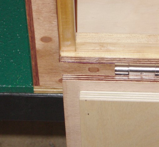

Here is a close up of the corner blocks

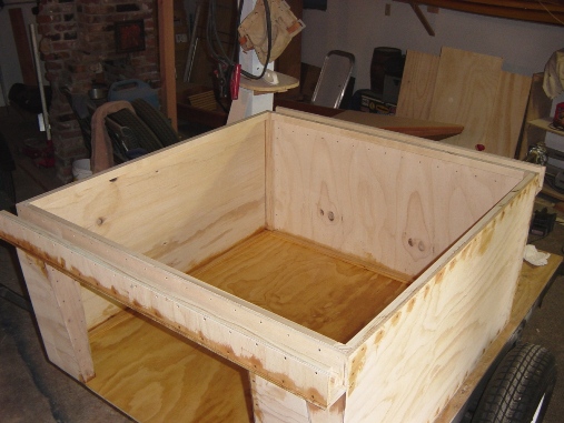

Postby schaney » Tue Apr 21, 2009 9:42 am

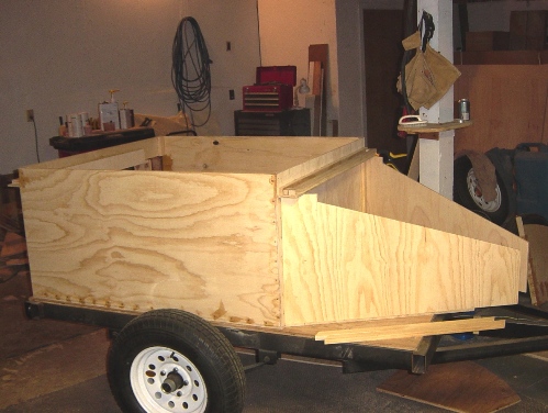

Next I added the side walls. Wherever I have exterior wall joints that needed to be smoothed out I glued them in place with thickened epoxy. The epoxy seals the edge grain of the plywood, fills any gaps and is waterproof. For all other gluing I use Titebond III.
Image Image Image Image
When ripping full sheets of plywood down to size and cutting angles, a lot of time I just use a straight edge and circular saw.
Scott

Now I moved to the back for working on the rear / access door area. This is one area I wanted to get away from the basic box shape by having a sloped back and angled corner.
I started by making and adding a portion of the rear overhang
Then I added the main rear panels, they have a 10 degree angle to them.
To do the corners I used a tape and glue method. The angle pieces are cut to size, shaped and then taped in place. On the inside fillets of thickened epoxy are applied to the edges. This glues the piece in place and provides a radius so the fiberglass cloth will lay flat. Once the fillets get to the tacky stage, I epoxy fiberglass reinforcement in place.
While the epoxy was curing I added the door side wings and taper panel above the door area.

Then I built and installed the vertical area under the front overhang where the nose box hinge will mount.

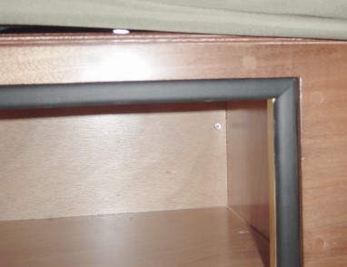

Q; how do you weather seal your doors?

Dsmith, I normally make doors flush and use a D-type seal in a channel cut into 1x2 stock. I've also used aluminum L-channel for holding the seal.
Lately been testing a ribbed and D-type with a wing seal, they seem to seal a little better than a D-type.
