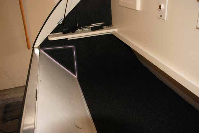

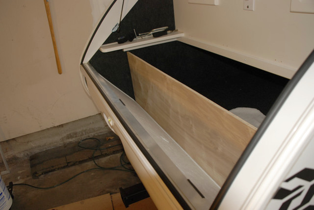

After removing the hinged lid, I was wondering if I could take better advantage of the unused room at the foot of the bed:
I test fit a bulkhead of 1/2" plywood (this still leaves an 80" long sleeping area):

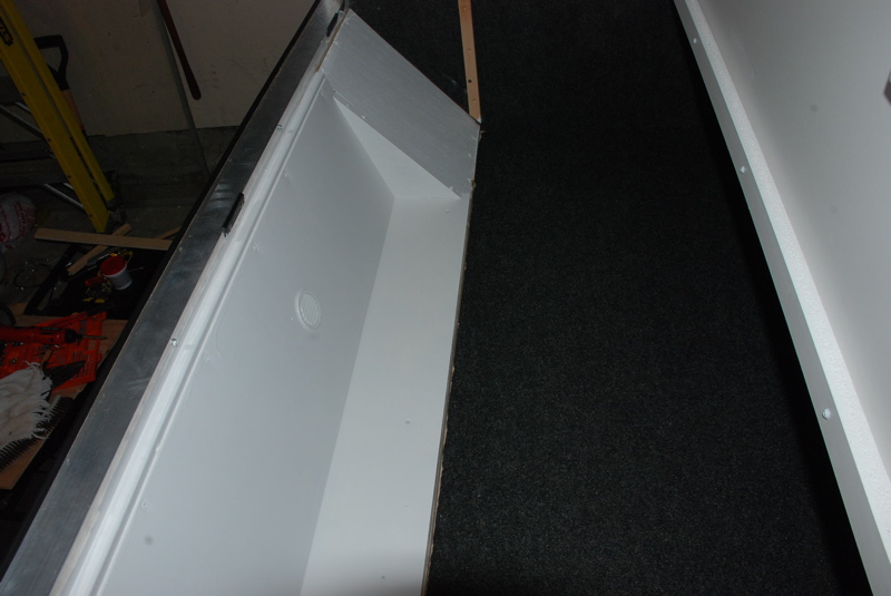

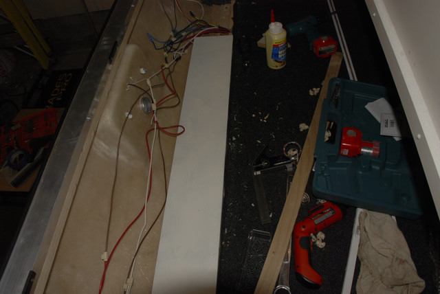

After removing the trim, I found that there was room for a 48" long, 6" wide board:

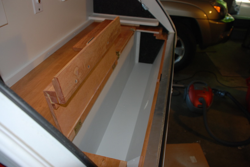

So I finished out the "trunk" with 1/4" plywood, including replacing the foil insulation and vent cap:

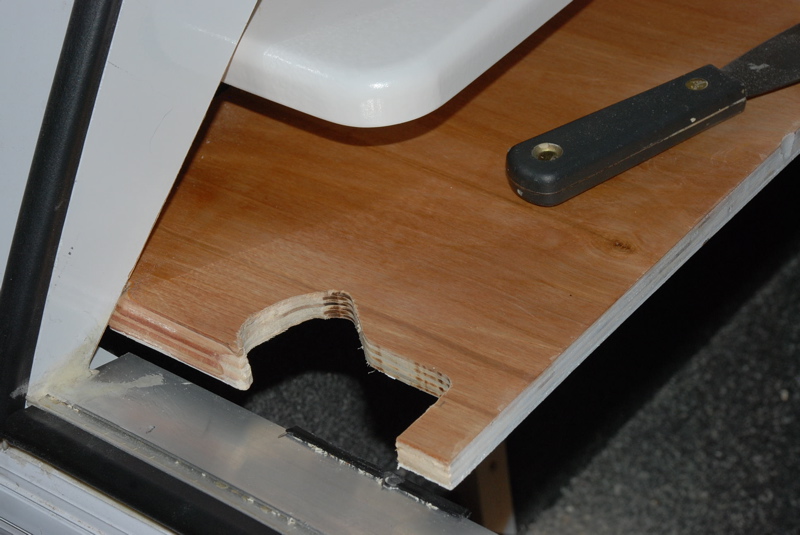

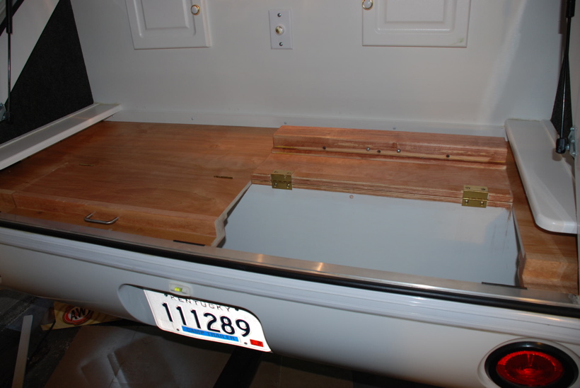

I ran into trouble when I installed the new "countertop."
I planned to simply screw it into the bottom of the existing supports the original lid laid on. This would lower the top (1/2" ply) about 2", enough to increase storage room, but not enough to significantly impact the toe room under it! It would also include two lids to access my new trunk that would reuse the original hinges.
I knew from the other thread that I'd have to cut slots in it for the latches, but I failed to realize that at this height those latches in the open position come in almost parallel to it. My slots were going to have to be huge! :?
Back to the drawing board. I finally decided to go with a stepped down ledge of sorts. This had the additional advantage of allowing me to support it at the rear and seal off the trunk area:

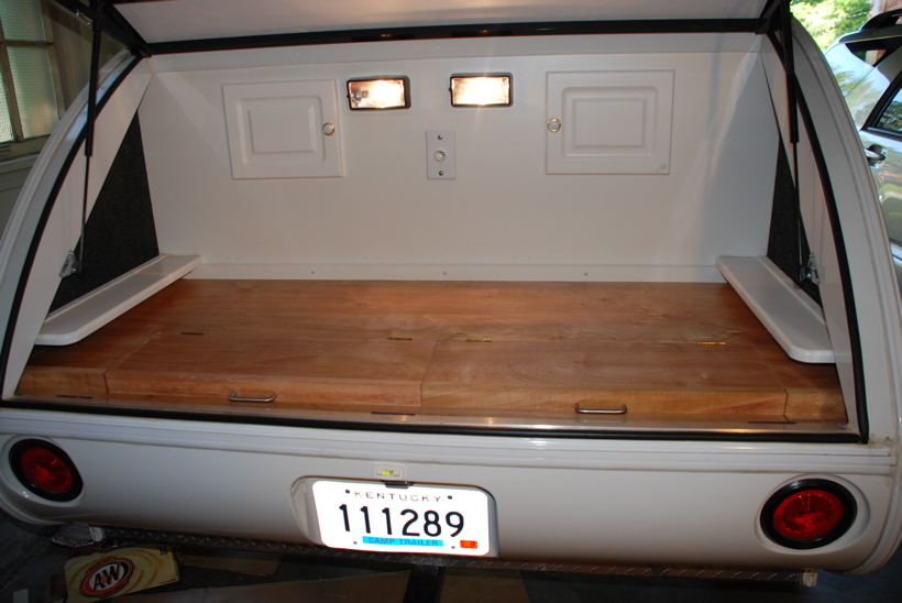

Here's the view with a lid open:
And both open:
The "trunk" is actually quite roomy. I can fit 2 bag chairs, a Coleman lantern, can of fuel, collapsible shovel, and various other odds and ends in there with room to spare. The countertop is now much sturdier and roomier, and no more bugs, cooking odors, or crumbs in the sleeping area.

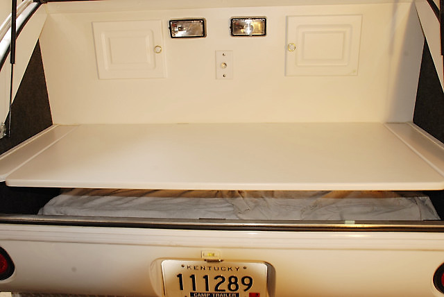

That is a great modification! I have a Little Guy like hiker chick except without her very nice custom paint job. The original shelf always sags and cannot support much weight. Patricia wants us to do something about that and yours is a great idea!
There was an earlier topic looking for a way to modify a Little Guy galley. This member had experienced a collapse of the original shelf from loading more weight on it than it could support. I hope he can benefit from your ideas and photos.
I am still trying to figure out how you sealed the counter top without interfering with the galley door latches. I am sure my closer inspection of your photos will reveal that. This is my stock galley except for the addition of lights and outlets. The center light is stock AA battery, not used much now that the 12V DC ones are in place.
