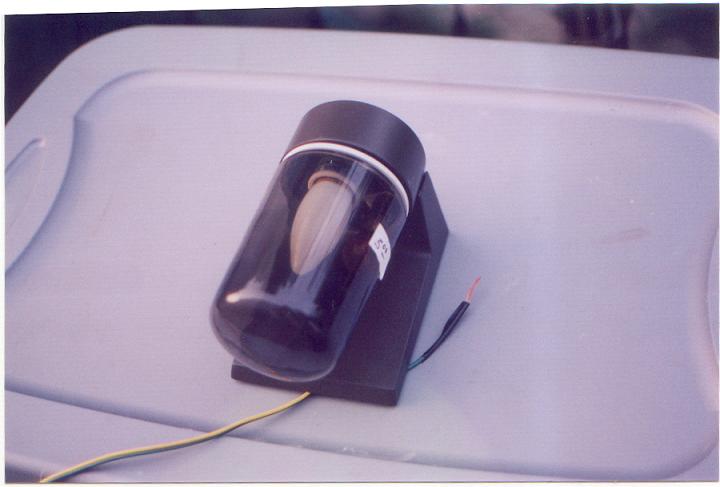

But, I remember someone on the T&TTT forum making their own jam jar light (which I thought was pretty cool).

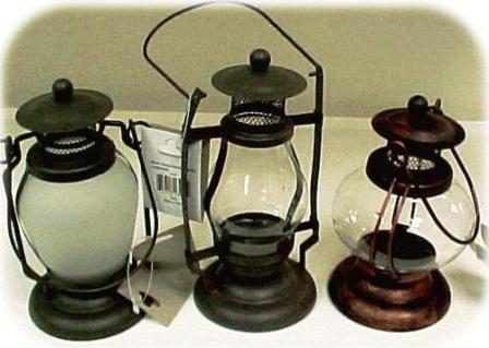

Specifically, I am also thinking it would be great to take a lantern mock-up of some sort, perhaps one of those ones that are used for tealight candles or the mini-kerosene lanterns, although I suppose one would need to remove the glass, then fit them with a 12v socket and use it for a light with personality and panache!

I've done several conversions on old lamps from 120 Volts, to 12 Volts.
Very easy, and doesn't cost much if you buy inexpensive 12 Volt trailer lights as a source for the guts.
Your idea of using lanterns would be an easy job.

These little kerosene lanterns were 5 something at Menards hardware and I converter them with the mini 120's above and the same 1157's for DC they are really too brite for inside on 12 volt maybe a dome light bulb and socket would be better.

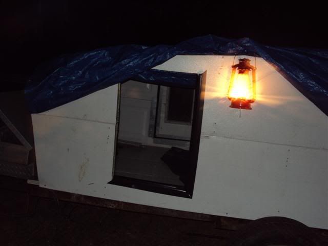

I used a $5 lantern from wally world as a porch light.
I gutted it and added one of those little side marker lights and a pull chain for a ceiling fan.
it's not very bright and I may end up going with an 1157 bulb.

eatatjoz wrote:I used a $5 lantern from wally world as a porch light.
Yes! This is exactly the sort of thing I was thinking of doing, except I've seen the same type of lantern about 1/2 size of the Walmart lantern for inside (I have a Walmart lantern, too). I like the idea of using the full size lantern outside.
How did you attach it to the camper? Is it permanently mounted (or does it come off and you plug it in when you get to camp)? Did you do anything special to protect the glass, or is it less fragile than I'm taking it to be?

Postby eatatjoz » Sun Jul 26, 2009 7:25 pm
It is permanently mounted. The glass seems pretty strong, and I can buy another one for five bucks if it gets broken.
The build's not complete yet so I don't know if it will survive or not. I'll have to update if this thing ever makes it to camp.
So far it's surviving construction. maybe it'll last. :worship:

I would really like to see some more examples, if anyone else has done this. I really like the look of the lanterns with the lights in them! The jar lights look great, too.
Hey Joz,
I really like the way your lanterns look, and that is just the sort of thing I was thinking about doing. How did you mount them on the side of the camper?
AL in Asheville :thumbsup:

Postby eatatjoz » Wed Jul 29, 2009 10:00 pm
I just used self drilling screws. Nothing fancy. i'm rethinking it to maybe look like it's hanging from the top.
you can find 12 volt bulbs at the auto parts store. they fit in a regular socket so it would be easy to modify a regular lamp.
