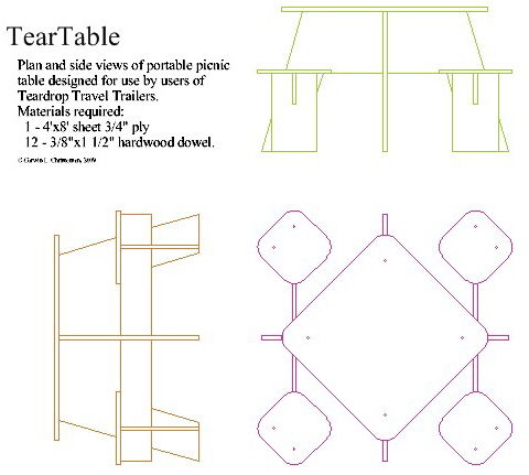

Due to a minor cold this weekend, :( I have found time to get the plans for a portable picnic table suitable for teardroppers completed. :thumbsup: I was able to get all of the parts out of a single 4'x8' sheet. 8)
Teaser:
The plans (printable to scale on 8.5x11) are available by request as two small .pdf files which I will e-mail directly to whomever wants a set (post or send me a message w/ e-mail address). WARNING: A prototype from these plans has not been built. There may be errors which I have not noticed yet. :roll: I will build a prototype eventually, but the irons in the fire say "not until spring." Pictures of completed prototypes now available starting on page 4
I believe that almost anyone will be able to get the pieces through the door in their tear. The largest dimension is the table top (30" x 30") and it could be cut in half and hinged if necessary. All of the other parts have a small dimension or are "U" shaped (legs) and should be able to work through most (if not all) doors.
My only request: Should you build a table using these plans, post comments and pictures to this thread.

I've already mentioned this to Mike, he said that a permanant location for download is possible, however, I hesitate to make a permanant post until the plans have been used a few times to work out any bugs. :shock:
For now, I will send a copy to anyone who wants it, just send me a PM or post with your e-mail address.

I have received several comments in the PMs that I have received, regarding drilling a hole in the top for an umbrella. Just a "heads up" to those that do this, the legs cross exactly in the middle of the table, your hole will have to be off center so that the umbrella doesn't hit the legs. :shock: Made that mistake myself...
One of the large versions that I built as a gift for someone (picture of similar table here) had a hole in the top for a umbrella. I think that the easiest way to locate the hole would be with the right diameter hole saw after the table is assembled, that way you could crawl underneath (or flip it over 8) ) and make sure you miss the legs. The person that I gave that other table to then used a bolt and wingnut diagonal through the legs to capture the umbrella pole in a "triangle" lower down and the umbrella needed no additional support. The larger table is quite a bit heavier than the TearTable will be, so your mileage may vary.
You are more than welcome to modify your table as you see fit (it is yours after all). Please send me comments on your modifications (good and bad) with pics if you have them as I use them to get ideas to improve the designs that I make.

Postby Corwin C » Tue Nov 24, 2009 11:38 pm
Classic Finn....
I have to admit, I didn't think of those of you who work in metric. :?
I took the drawings, told TurboCAD to make the dimensions in mm and made a new layout PDF. You should receive one in your inbox shortly. I didn't take the time to make sure that the conversion is accurate but it was definitely easier than manually doing it all.
If anyone else would prefer metric, let me know when you request the plans.
Corwin
