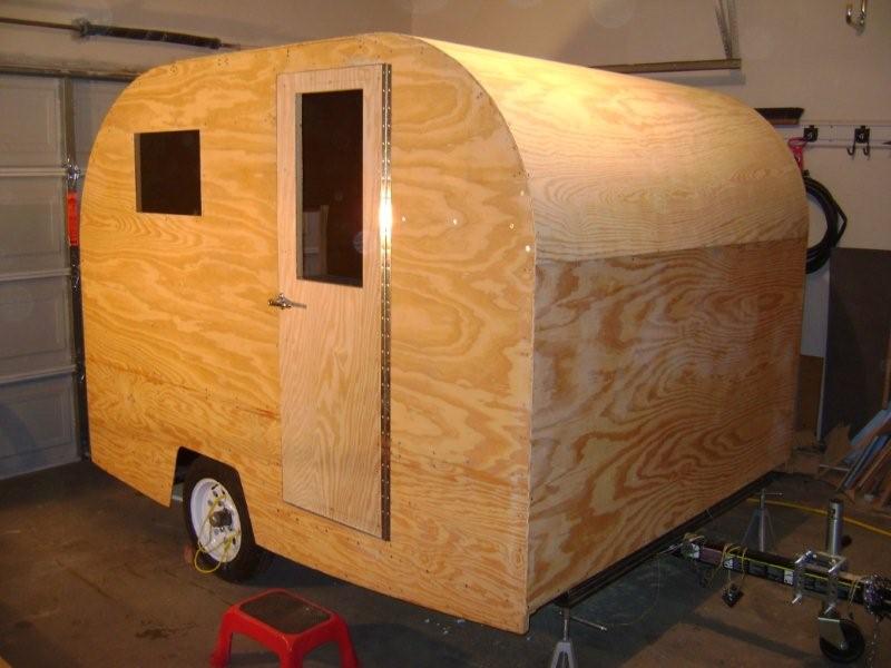

I've been working on my project for a couple of years now, updating my album as I went along. I never started a build thread, so I guess it's about time. The historical pics are in my album.
I just closed in the top and front. Will try to do the back over the weekend.

I really like the form and functionality of the shape of the lower skirt on the sides...looks great, much improved over original to my eyes. Sort of a grown up version of the Puffin with the insulation and all, but still short and sweet. Keep up the good work.

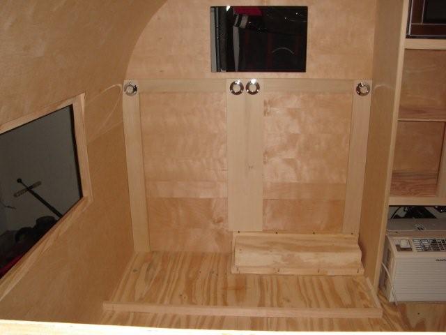

You've got a beauty... but my question is, teardrop for 4? I only see room for 2... can you enlighten me?
problem solved!

look at his album. photos # 6 & 7. see the u shaped closet rod brackets? I would bet they are to put an upper bunk directly over the lower dinette berth. And that way it appears either one or two bunks can be installed.
pretty ingenious!!

mikeschn wrote:Hey Jerry,
This picture was labeled support for Kid cots think it will have a bunk system, will be neat to see.

Postby mikeschn » Fri Dec 04, 2009 8:28 pm
Ah yes, I see the bunk system brackets... thanks for pointing that out!!!

Mike, yes John has it right. The closet brackets will support two cots. I forget the distance between the bed and the cots, but I made certain there was enough reason for me to sleep on my side. I embedded t-nuts into the supports on the wall that the closet brackets screw into before I installed them, and I'm using stainless steel hardware. My two sons are young, so weight-wise we should be good for a while.

Also, it appears you kept the original fenders and just boxed over the top. how did you make the area around the fenders weather tight? Or did you remove the fenders before you put the fender boxes on?
